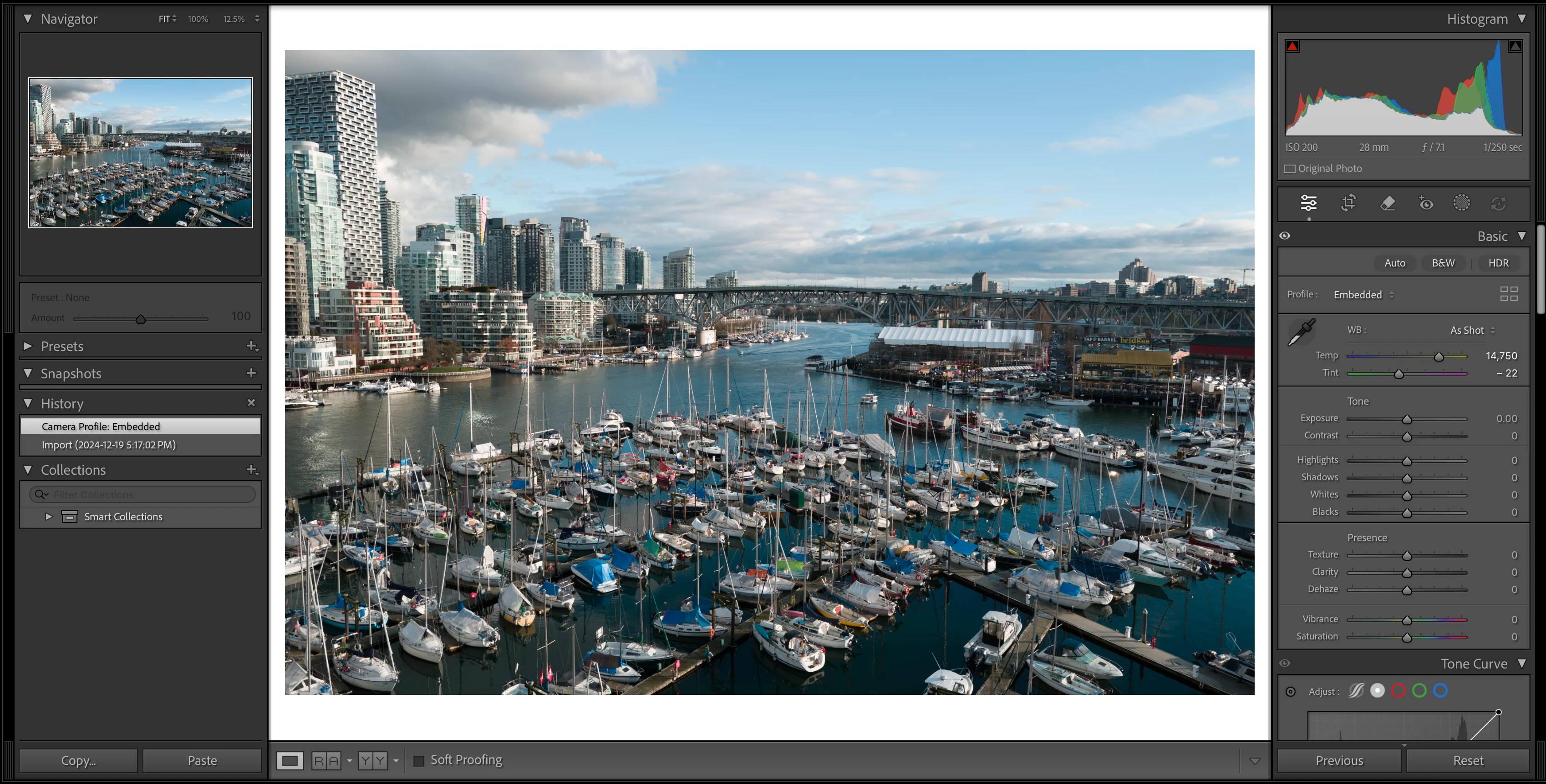

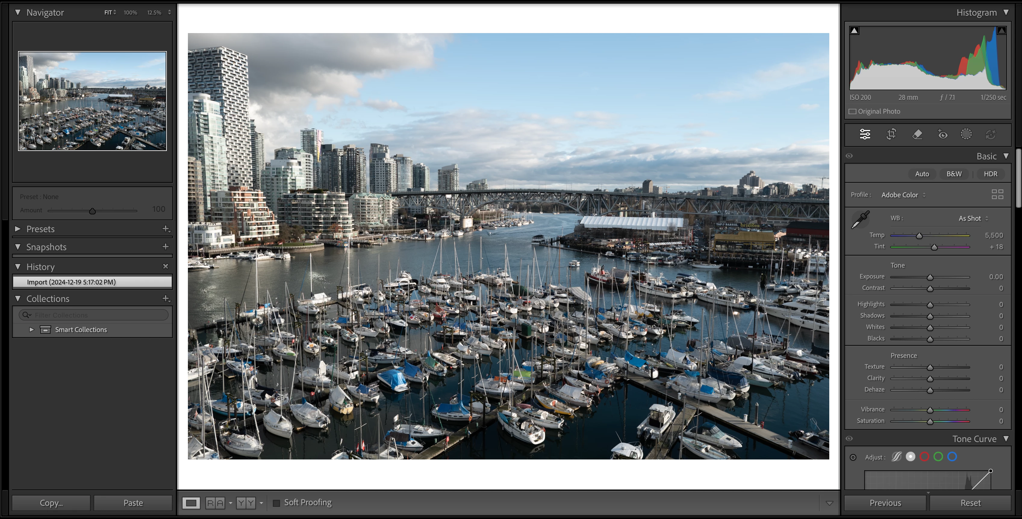

I've noticed the white balance, when switching over from the Adobe Color to the Embedded, behave very strangely.  Specifically the white balance temperature and tint drastically changes and causes overly saturated colours to be applied to the pictures.  I've attached Before and After screenshots showing the strange behaviour I've noticed.
The Before picture shows the photo with no edits and the Adobe Color profile being used.  The WB temperarture and tint shows 5,500 and +18.  The colours in the picture seem quite normal as well for a RAW file with the Adobe Color profile applied.  The After picture shows the photo with no edits but with the Embedded profile being used.  The WB temperature and tint then shows 14,750 and -22.  This is very strange to me as the temperature and tint values look wildly inaccurate to what is being shown in the picutre, and not only that, the picture now also looks to be overly saturated specifically the blues which is strange cause the temperature is showing to be on the warmer side.
My Leica Q3 firmware version is 3.1.1 and my LrC version is 14.4.  I started noticing this issue appear in December 2024 when I updated both my Leica Q3 firmware to 3.0 and LrC version (I can't remember which version of LrC it was updated to in December 2024).  Prior to December 2024, the change from Adobe Color to Embedded profile behaved normally with only slight changes to the WB, colour saturation and contrast being applied to the photo.  I've gotten in touch with Leica and they've informed me the issue I am seeing has nothing to do with the Q3 firmware updates and that LrC is just not compatible yet with the Q3 Embedded profile.  However, this does not explain why I was not seeing this issue prior to December 2024.
