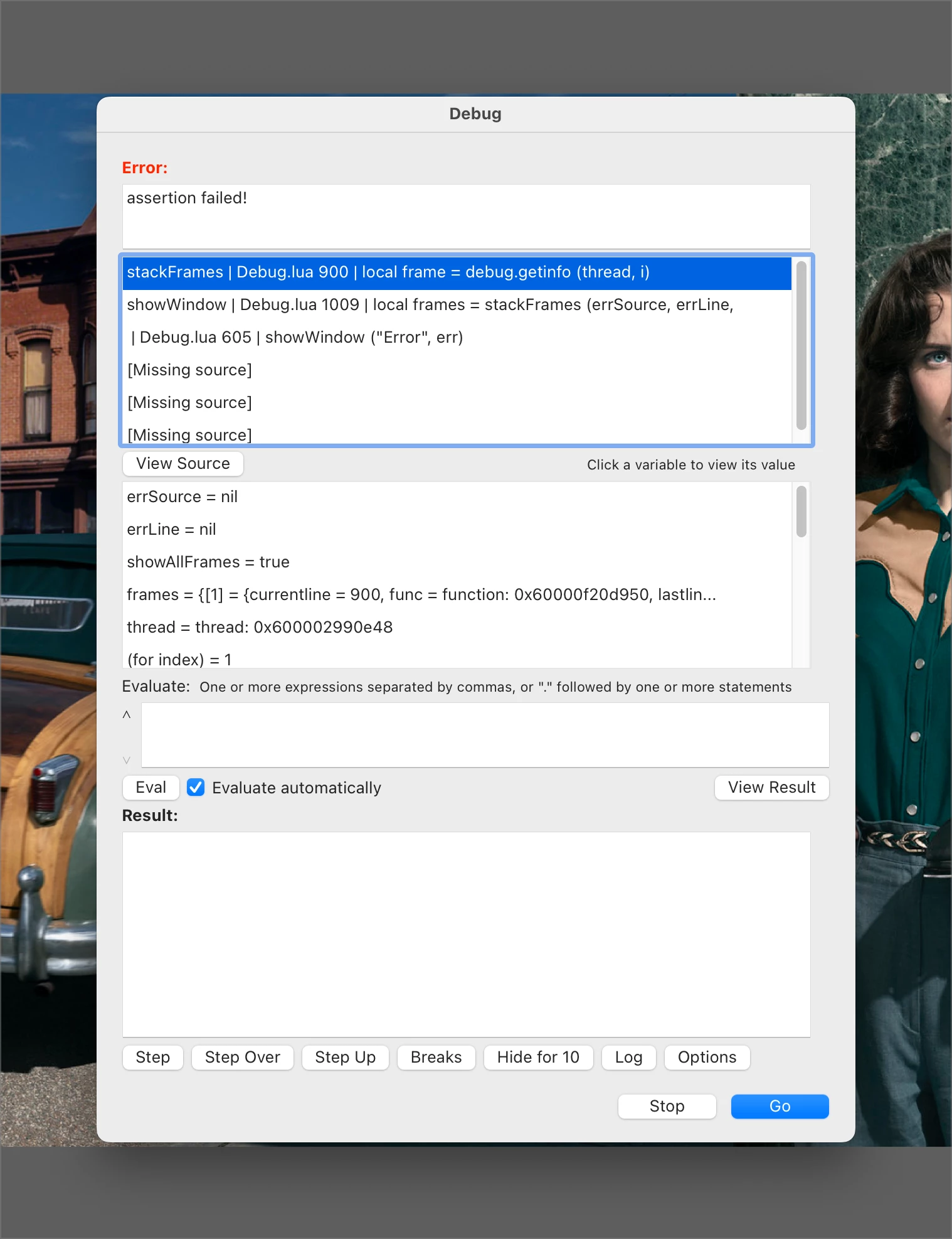

I'm trying to get the @johnrellis Debugging Toolkit working and encountering "assertion failed!" in Debug.lua line 900, which is
local frame = debug.getinfo (thread, i)
I'm not quite sure how to resolve this.  Any help would be appreciated!
Lightroom Classic 13.2
SDK 13.2
Code and debugger screenshot below
local Require = require "Require".path("/Users/paul/src/third-party/debuggingtoolkit.lrdevplugin").reload()
local Debug = require "Debug".init()

When LR's Lua interpreter encounters an error, by the time the toolkit's Debug or Zerobrane's debugger gets control, the stack has usually been popped! So it's a little tedious to single step until you find the error.
In the code above, it's the expression folder.getName() -- it should be folder:getName().  That's a very common mistake, and it always results in assertion failed.
I've attached a screen recording of how I debugged that. I set a breakpoint on line 25 and then single-stepped from there.

Thank you @johnrellis, that was very helpful.  I am debugging now!
