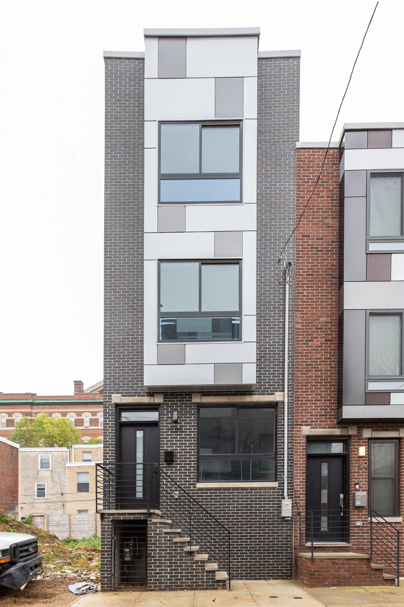

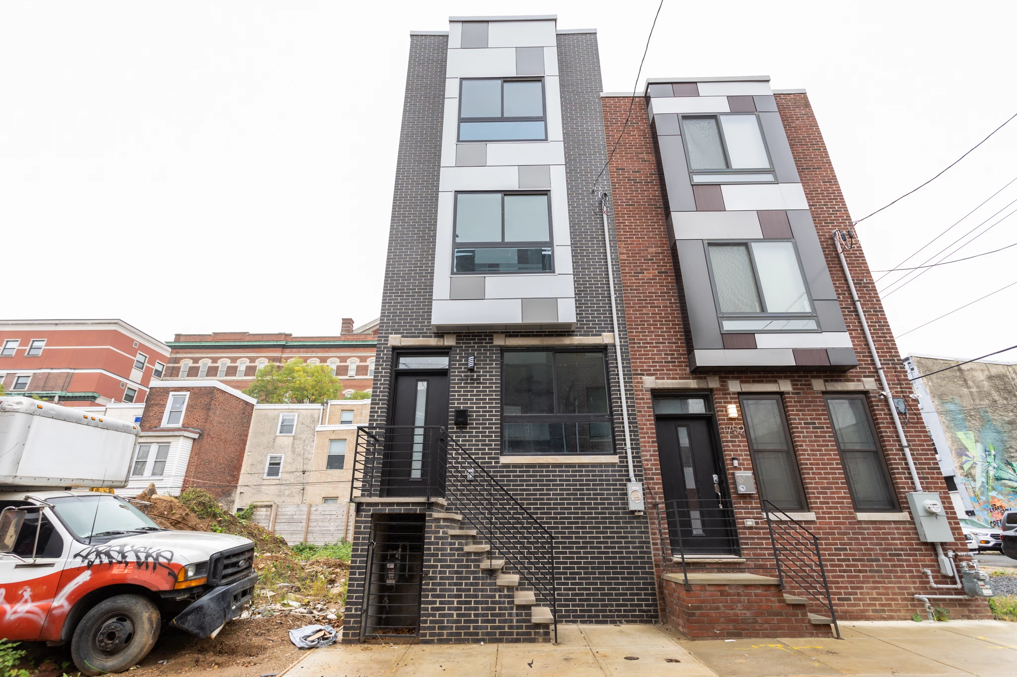

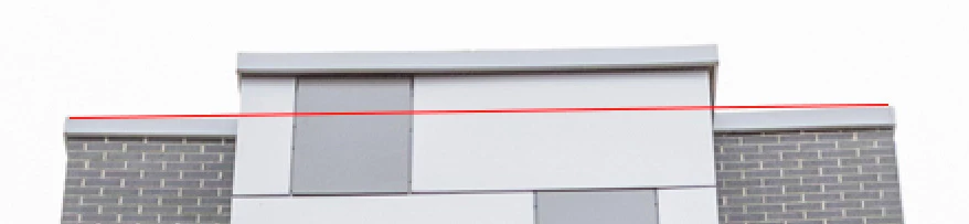

Wondering why the image looks concave after correcting for verticals in LR Classic. I'll attach a before and after perspective correction. Both images have the correct camera and lens corrections applied. Look at the top of the building for the concave effect. The horizontal line ofthe top of the building should be straight but it's not.
Correct answer JohanElzenga
It's more difficult to see, but the before image has concave horizontals too. You can see it clearly on the right side. So this is probably not a perspective correction issue, but a lens profile that is less than perfect.

exhaustino
October 28, 2022
Good point! I guess it gets exaggerated when corrected for perspective. I'll look into the lens profile issue. Thanks!

exhaustino
October 27, 2022
Interesting. I tried manually correcting it in the same panel but it didn't
have the same curve so the image just looked worse. Tried both
directions (positive and negative). I've been shooting architecture for
almost 7 years and have never had this issue before.
