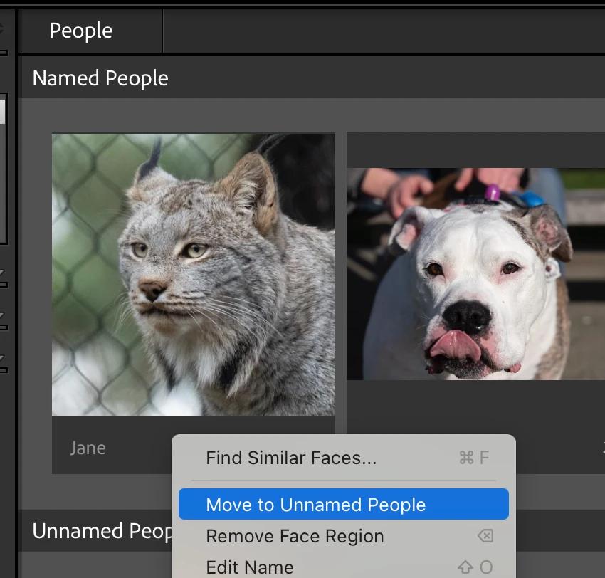

"there are 20+ photos with the wrong name."
Go to People view. Right-click the thumbnail for the wrongly identified person and do Move To Unnamed People:

"I would like to retain the 70 that are correctly identified and just remove, with one operation the 20 photos that are incorrectly identified."
1. Make a catalog backup, a good thing to do before you start any bulk operation on catalog organization that you haven't done before.
2. Put those 20 photos in the Quick Collection.
3. Select the Quick Collection.
4. Go to People view.
5. Right-click the thumbnail for the wrongly identified person and do Move To Unnamed People. Only those 20 photos will be affected.
