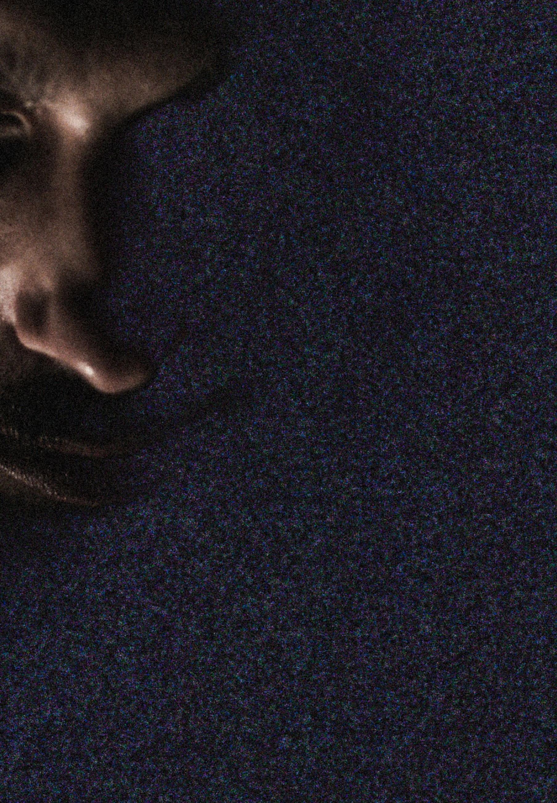

Blue grain in black areas after export
Hello! I am exporting a photo and noticed that after export, the black portion of the photo has blue grain. This blue grain does not appear in LR itself before export, and am wondering how to fix this issue?
I used various brush tools in those areas so maybe that has something to do with it? Not sure as to what could be the cause.

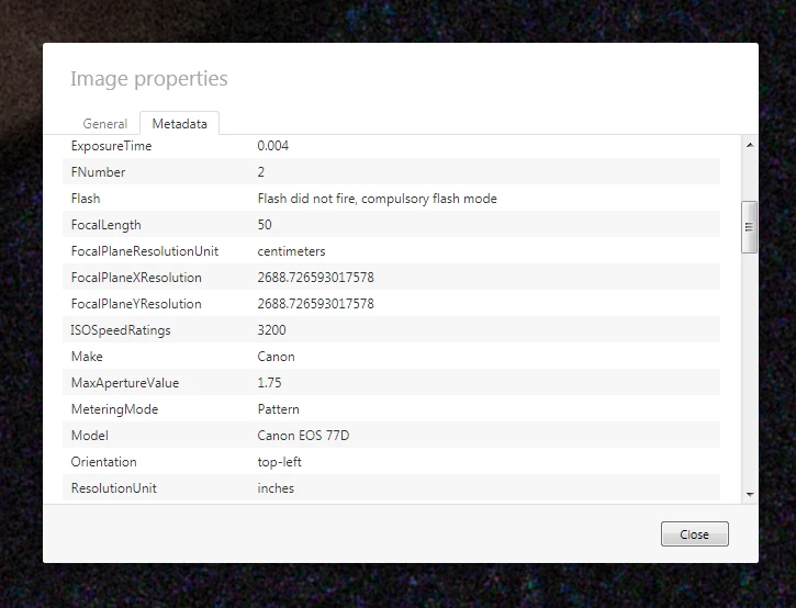

This is high ISO noise, mostly color noise it seems, but probably also some luminance noise.
You are using a camera with a small sensor at ISO 3200, so noise is inevitable.

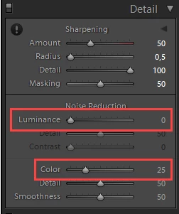

You need to apply some noise reduction in Lightroom, and you have to do this at 1:1 view. Any other view (like Fit view) will be inaccurate and misleading because the image has been scaled. Only 1:1 gives you a true representation of the image.
You will find noise reduction in the Detail panel in Develop.
Do color noise first, drag the slider until the colored speckles disappear, then do Luminance noise.
Luminance noise reduction should not be overdone, it will give the image a "plastic" look, so it's better to have some noise in the image.
And remember, use 1:1 view.

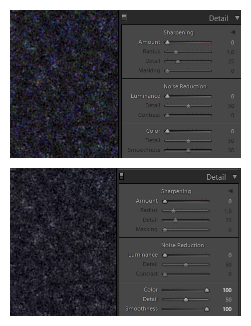

Viewing Kim's screenshot at 1:1 reveals that the noise isn't just blue – it's red, green and blue.
And using a curve will not remove it, that will just change the color balance in the entire image.
Setting the Color slider to 100 in Lightroom removes most of it, and setting Smoothness to 100 makes it even better.
The image still has a lot of luminance noise, and it is so coarse that it's impossible to improve with the Luminance slider. I have a feeling that the image has been sharpened with the Masking slider set to 0. Using a high value here (70-90) would at least prevent the noise from being sharpened.
