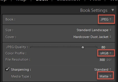

EDIT- You'll need to use 'Export Book to JPEG' in the Book module with sRGB color profile. That's what is used in the PDF uploaded to Blurb.
Then open the page(s) JPEG with the issue and use PS soft proof with the Blurb.icc profile. You can then determine what font and/or background color provides better readability.
