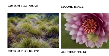

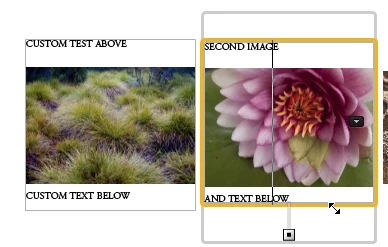

If I think I know what you are trying to achieve- then you have some difficult editing ahead-
I can place the "Photo Text" box Above each photo, Uncheck [Align with Photo], and then expand the type by placing multiple line 'Returns' between the text above and below the photo, but alignment is difficult.
The page will print to a JPG and PDF ok as below, so I have no reason to suspect that it will not print ok by Blurb.

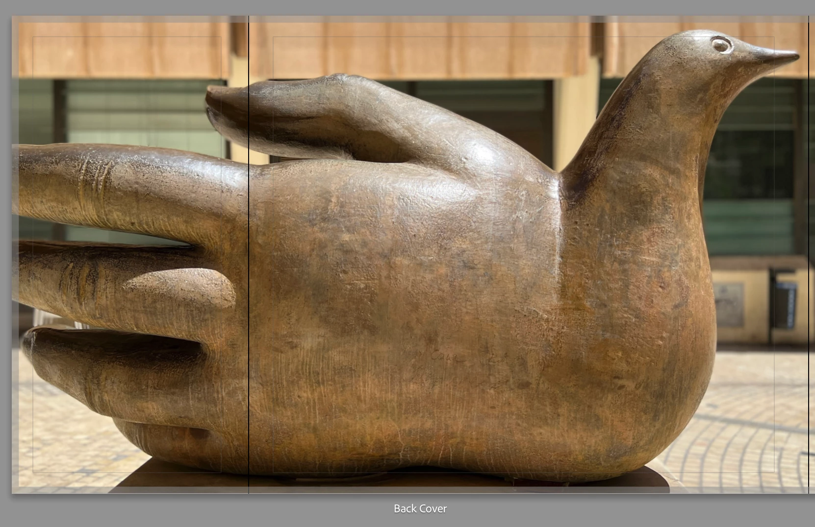

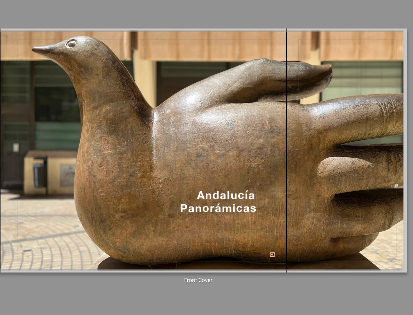

I have published many books using Blurb Plugin in LrC.  I have experienced the red box issue a few timees in the past; fixing it required a modest change in position of title. On attached cover,  I had to move the book title to the center of the page (landscape format) in order to eliminate the red box. I have set up the cover from scratch repeatedly and nothing  eliminates the red box. Also the photo bleeds on the cover; there is always a translucent border; see back cover attached. On front cover, border appears to be solid gray, not translucent. Is this a problem, too? I emailed Blurb support; response was "contact Lightroom." Appreciate any help and/or advice.

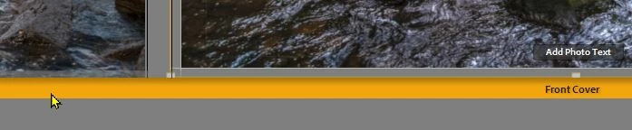

"there is always a translucent border",  Yes, that is a 'Trim' area that warns you the photo might be clipped when the guillotine cuts the book Dust Jacket (which I see you are using!)
The "solid Gray" maybe because you have a Page Background set for the Front Cover- Select Front or Back and check if you have a color set in the Background Panel.
Also turn on guides that give a visual indication of the photo Cell borders- which you should be able to Drag right to the very edge of the page, thus hiding any page background, (but also allowing the edge of the image to be trimmed!)

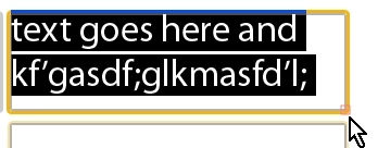

But the Red X Box indicates that there is not enough space in the Text box to contain all the typed text.
Lr Text cells do not work like many other programs that will split the text and carry-over into the next available cell or page.
You can test this by typing a few words, select the text, then increase the Character size greatly- you will see the red X box appear.
Editing the Photo Text cell-
