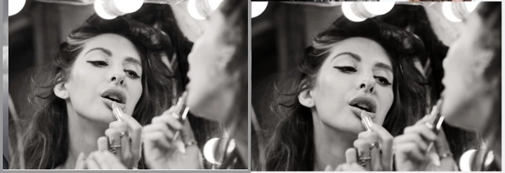

I put pictures in the cells and print. What the Epson preview (and print if I allow) shows me the lightroom image  been heavily clipped at two edges and lightly clipped at the the other two, but it does print right to the edge of he the paper.
Lightroom classic on the left , Epson preview on the right

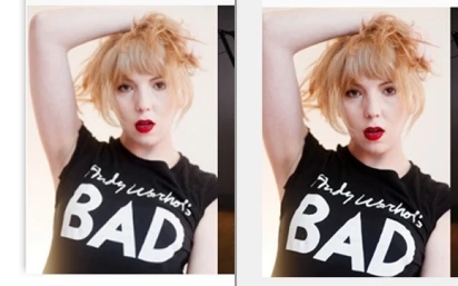

The first image is from the inverted row so it is the top left corner of the page. you can see more the more of the hands at the bottom of the frame. The second one appears that way up and look under the D of “BAD” on the T shirt or at the elbow and you’ll see it is clipped.

    This varies by printer manufacturer / model, but two variants of Borderless printing exist: with automatic added scaling to compensate for any paper misalignment, or true-to-scale (which is the same as standard printing, only not imposing any sheet margins).
    LrC would never itself be adding scaling to borderless jobs: this is applied (or not) in the print driver.
    So it could be that (so far as the print driver options that LrC is employing) the mode of borderless printing has been selected that is not true to scale.
    Lower-end devices may not offer any choice on this, perhaps because it is presumed one is sending a single image at a time - whereby accuracy will be less important than fully covering the paper. In that case, the only way to achieve accuracy may be to print non-borderless but onto oversized paper - and then trim.
    But in the driver options for my R3000 I do recall a “true-to-scale” option being available. If you have filled the paper size, you will then need the paper to be feeding exactly straight and aligned of course: no wiggle room.

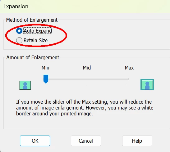

    Thanks for the reply, it got me to experiment a little more.
    In the Epson driver when borderless is selected an expansion button appears, and the key is to NOT selected Retain size, but select auto-expand mininimum .
    Dialog box
    So it looks like the problem is with the driver, when I have a bit more time I’ll see if that is why Photoshop says a 419x296 image will clip when printed borderless on 420x297 paper, it knows what is going to happen but can’t explain what’s wrong with the driver setting
