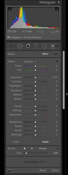

    For me a picture tells a 1000 words
    Here is the activated Adjustment brush without the panel collapsed as Johan so correctly mentions above.
    This should give you area-specific editing control. Note I have collapsed the that particular brush Properties at the bottom of the screen shot.
