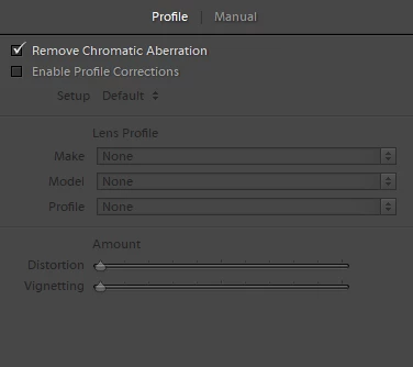

    This is how my Lens Corrections tab looks like with a fresh file,converted when importing it:
    "Remove Chromatic Aberration" was checked automatically though.

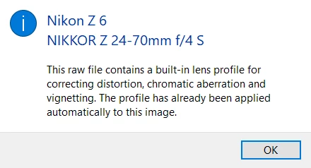

    I imported a .nef and the " Built-in Lens Profile applied." message appeared! Then I converted it to .dng per "Library - Convert Photo to DNG" and the message is still showing. When clicking on the the following message appeares: "
    ... as it should. But why did it show up with the other .dngs and now it does it only with this fresh file? Does the message disappear after a while? It's still there after restarting Lightroom.

    Turning on vignette and distortion correction in the camera will have no material effect when shooting Raw, apart from perhaps slightly slowing down the camera's operation (since the camera is then applying these corrections during its own internal Raw conversion, while generating JPG data). It may be that the camera manufacturer supplied Raw converter would behave differently depending on these, and other, in-camera settings but Lightroom will disregard these and follow its own methods only.
    I suggest that if "Enable Profile Corrections" is greyed out and disabled in LR, you can safely assume that embedded lens data - which is not the same thing as a profile - is being applied.
