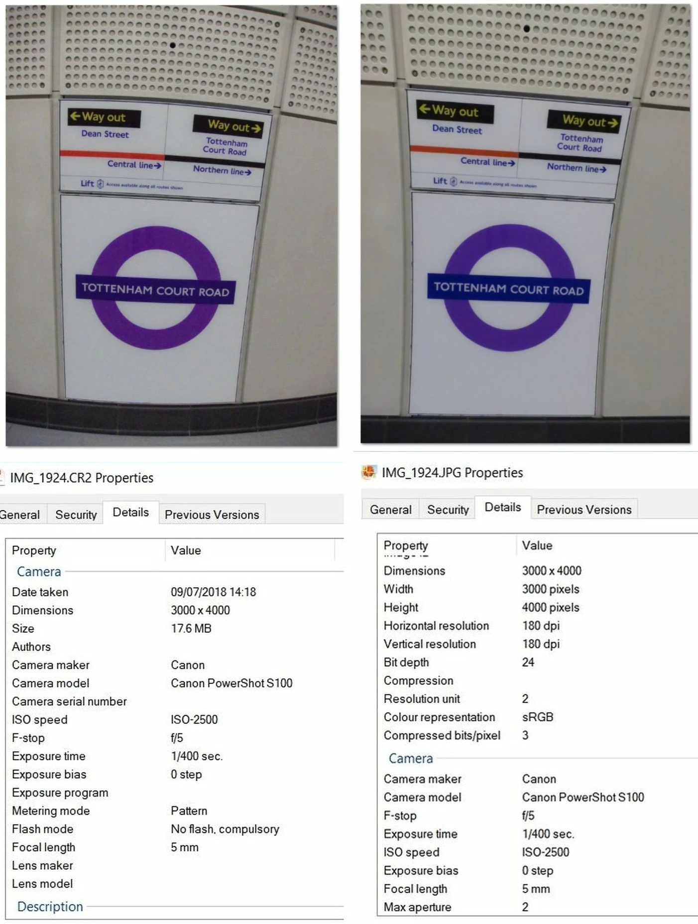

    Regarding the above problem concerning automatic cropping when loading RAW (CR2 and ARW) files into Lightroom 5, I have now found that using the RESET as above works for ARW files from my Sony camera but not for CR2 files from my older Canon Powershot S100
    The RESET in effect invokes the LR Crop tool and alters the setting from "As Shot" to "Original" and this returns the edge contents lost
    I have attached an example of the jpg and cr2 versions of an image taken on the Canon and it seems to be impossible to get the edge contents back into Lightroom after the image has been loaded even using the RESET/Crop Tool method that works for ARW files. It has no effect at all on the cr2 file
    I attach screenshots of the jpg and cr2 versions as photographed before input to Lightroom. I cannot get the extra L and R edges to apper as shown on the cr2 image
    Martin
    August 12, 2018
    This would be different from the cropped edges you recover from the other camera when the aspect ratio is set smaller than the full raw size.
    It looks like the jpg image from the canon S100 has lens corrections baked into the image from the camera. (notice the black tiles at the bottom of the frame in each)
    To get the same in the raw CR2 image you would enable lens corrections in LR.
