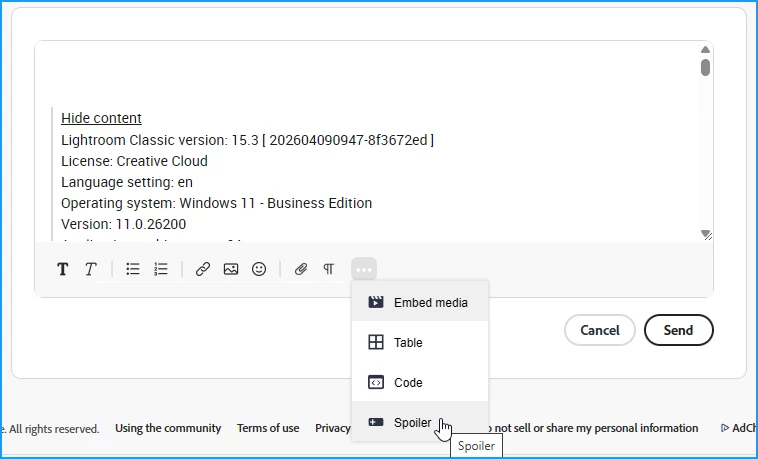

    Please go to Help > System info in LrC, click the Copy button and paste in a new reply.
    Before pasting, click the three dots in the toolbar, and choose Spoiler.
    Then paste the system info, which can now be optionally hidden to avoid excessive scrolling.
