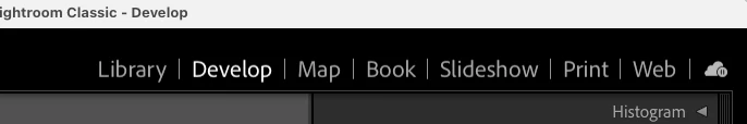

- Click Develop in the upper-right corner:
- Do the menu command Window > Develop.
