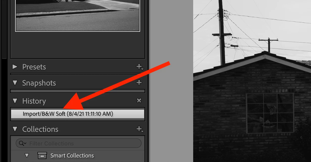

Aug 3, 2021 6:17 PM UTC
/EDITED/AFTER EXPERIMENTATION/
In your video, I notice that you already have some basic edits in an image just imported. I also notice in your Library Module that you may have touched Quick Develop, but I have no idea if anything has actually been changed.
So, preset during import? Quick Develop?
Thing is either of those would be reflected in the History panel, in the Develop Module, at least as part of the wording in the first state, and no such wording exists.
So, how are the basic edits occurring?
Is that a clue?
whaun2Author
Aug 4, 2021 11:13 AM UTC
Preset during import.
I suppose I could make a Fuji-only preset for import that includes the color profile assignment.
GoldingD
Aug 4, 2021 5:58 PM UTC
What particular preset.
And I wonder why it is not stated in the history as part if the first state. The import.
like this example:

whaun2Author
Aug 4, 2021 11:24 AM UTC
You raised a good point about Fuji and the Fuji profiles. So I pulled up a DNG from a Canon 6D and replicated the issue with a non-Fuji profile (Adobe). See attached video for demonstration.
