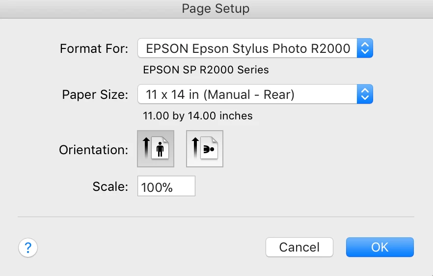

Updated to macOS High Sierra, 10.13.3 and could not print from Lightroom CC. Installed Lightroom Classic and I could print from there. It is not not printing again. I can click Print and see the progress bar loading the print but printer does not respond; no error message just stops process. I use Epson Stylus Photo R2800. I can print from photoshop with no problem, so it seems to be a Lightroom problem. Any ideas??
    Correct answer JoeKostoss
    Its the paper source in the printer driver that Lightroom won’t recognise. Ok with Photoshop.
    Correct, so you need to double check the Page Setup in Lightroom to assure it is the same as the paper is loaded when printing from Lightroom.

    I too cannot print with Lightroom Classic after Sierra upgrade.  Always a problem after Black ink change.  Error message
    Printing has been canceled because the paper source selected in the printer driver does not match the paper loaded in the printer.
    Works fine in Photoshop CC 2017.  Printer dialogue Matt matches request in Colour management .
    I note no one answers the posts.  Where can I get help.
    JoeKostoss
    March 31, 2018
    I get this message occasionally.  It means what it says.  Check that the paper is actually loaded in the printer in the same feed tray as is selected in page setup.
    In the example above, if the paper is loaded in the main tray and not the rear slot, the message will appear.  the usual case is the reverse where I might load the paper in the rear slot, but the main tray is selected in the driver.  I suggest you check these carefully.  I am not sure why it happens, but changing ink may reset the printer.
