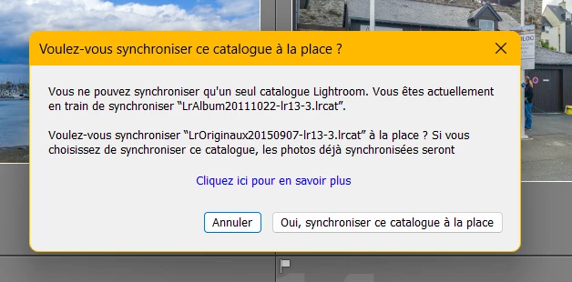

A chaque fois que je démarre Lr Classic avec mon catalogue NON synchronisé, il s'affiche ce foutu avertissement : "Voulez-vous synchroniser ce catalogue à la place ?". (Voir 1ère image jointe)

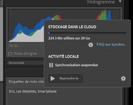

Je précise que l'état de la synchronisation EST BIEN A : "Synchronisation suspendue" (Voir 2eme image jointe)

What you describe is normal behavior, if this catalog has been synced before.
However, once sync is deactivated for a catalog, the setting is stored within the catalog, and it should not ask again.
I tried to reproduce with a new catalog. If I open the second one, in which sync is deactivated, it does not ask me to change the sync. It would ask me and show the dialogs you see when I would hit "Start Syncing". That is how it looks in the un-synced catalog:
