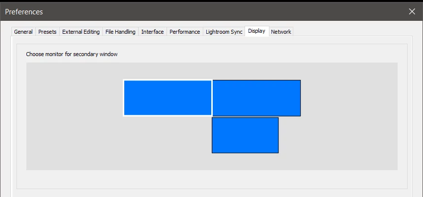

    October 9, 2022
    Under Edit > Preferences (in Windows) select the Display tab, and you can choose the monitor for the secondary display. I imagine it's similar for Mac, wherever the Preferences are.

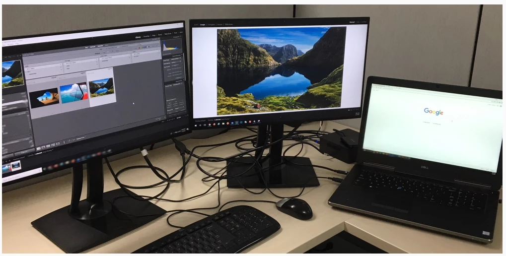

    April_W
    February 7, 2018
    Similar to what Mediapix posted, this setup worked for me. I set monitor #3 as my main display (select monitor #3 and check the box under the "Multiple Displays" section to "make this my main display"). Then drag monitor #1 below monitor #2. Now the primary Lightroom window is displayed on monitor #3 and the secondary LR window is displayed on monitor #2. The only catch, and it's a very tiny catch, is that to get to monitor #1, you'll move your mouse DOWN to monitor #1 instead of directly to the right, from monitor #2, just as shown in the diagram below, because your monitors are no longer configured in a straight line. Hope this helps.

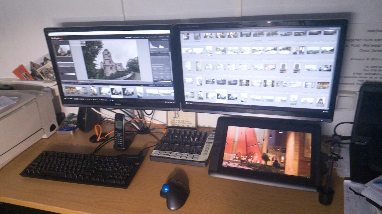

    August 18, 2017
    It works fine for me now.... Dutch Windows10 with 3 monitors on 2 graphic-cards. So also simply possible to calibrate all 3 seperate
