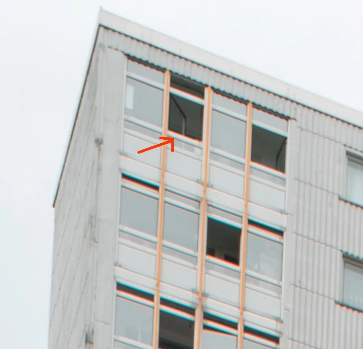

I've got a real problem with chromatic aberrations in Lightroom 2015.12 Camera raw 9.12.
Camera Nikon D810, Lens 24mm f/3/5 Tilt-shift.

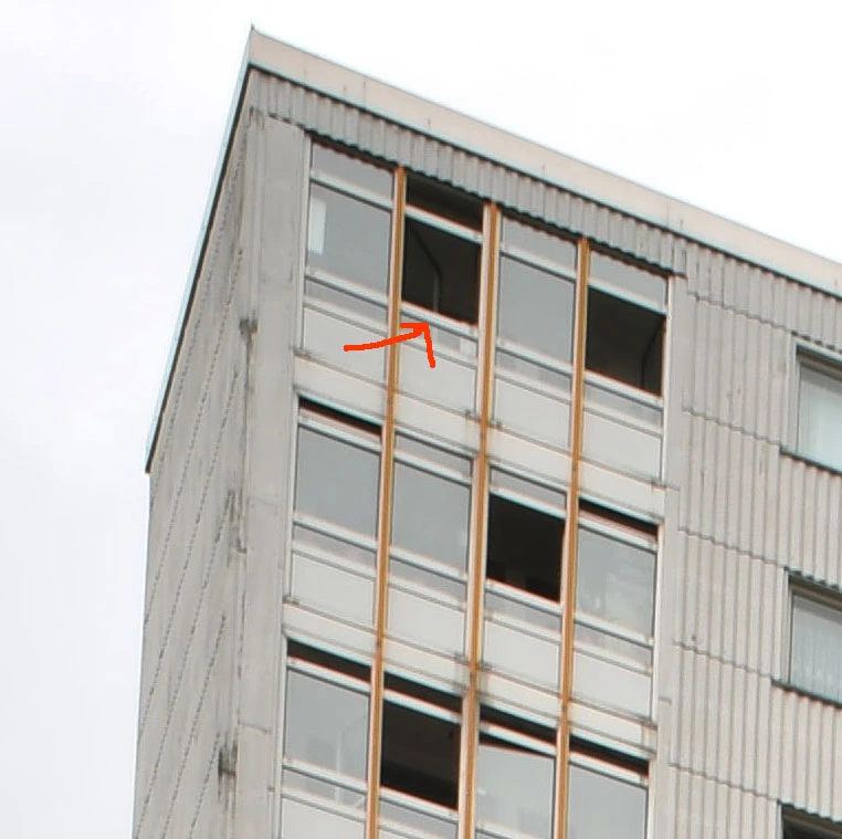

Jpegs from camera are fine without any chromatic aberrations.

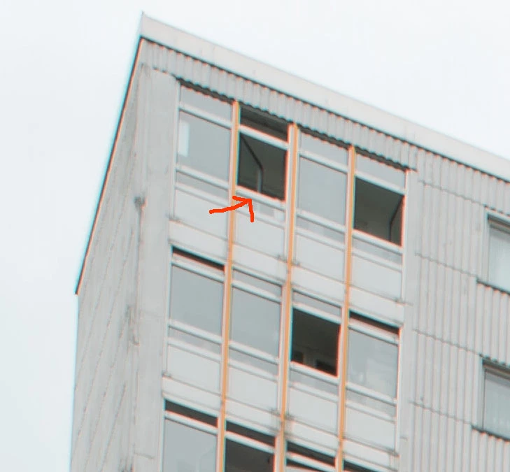

But I really need raws. And lightroom CAN'T remove chromatic aberrations. Sometimes it makes the image even worse.
I understand it's not a typical lens. And it needs more advanced algorithm to work with it. Anyway the camera itself somehow manages this challenge.
I love lightroom and want to use it, and I really hope Adobe adds an algorithm for such lenses.
Examples:
remove aberrations ON:
remove aberrations OFF:
jpeg from camera or Nikon soft conversion - aberrations are well controlled throughout the all picture:

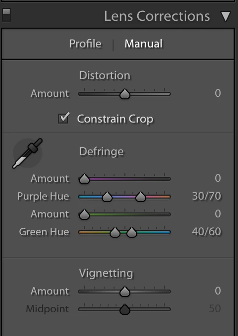

Sounds like your getting CA in shift areas only.  Certainly there's no lens profile for any TS lens.  But manual corrections do work.  Just do them in the area they are needed and not as an overall move.  In this TS Lens case I'd recommend correcting what's needed and putting that together with the good portion of the image in PS.

Yes, because the lense is tilted, the lateral aberations are bigger in one part of the image and smaller in another. The algorithm tries correcting and fails either this side or that.
Currently mainly because manual local retouch is too long, i use this workflow:
1. Raw to 16 bit tiff in nikon software with proper lateral aberations correction, flat curve.
2. All other adjustments in Lightroom.
3. Retouch in Photoshop.

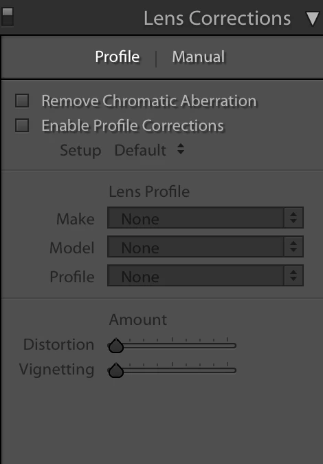

You can easily remove CA in LightRoom using Lens Corrections.  Check the box and away you go.
If (like me) you want to do more than automatic, use the Manual tab
Choose which CA and hue your bothered by and just fix that.

Thanks, Bob, I'm aware of this lightroom functionality. The manual mode works in a somewhat different way. And often eats needed detail. While true correction of aberrations adds sharpness to the image due to alignment of color chanels.
