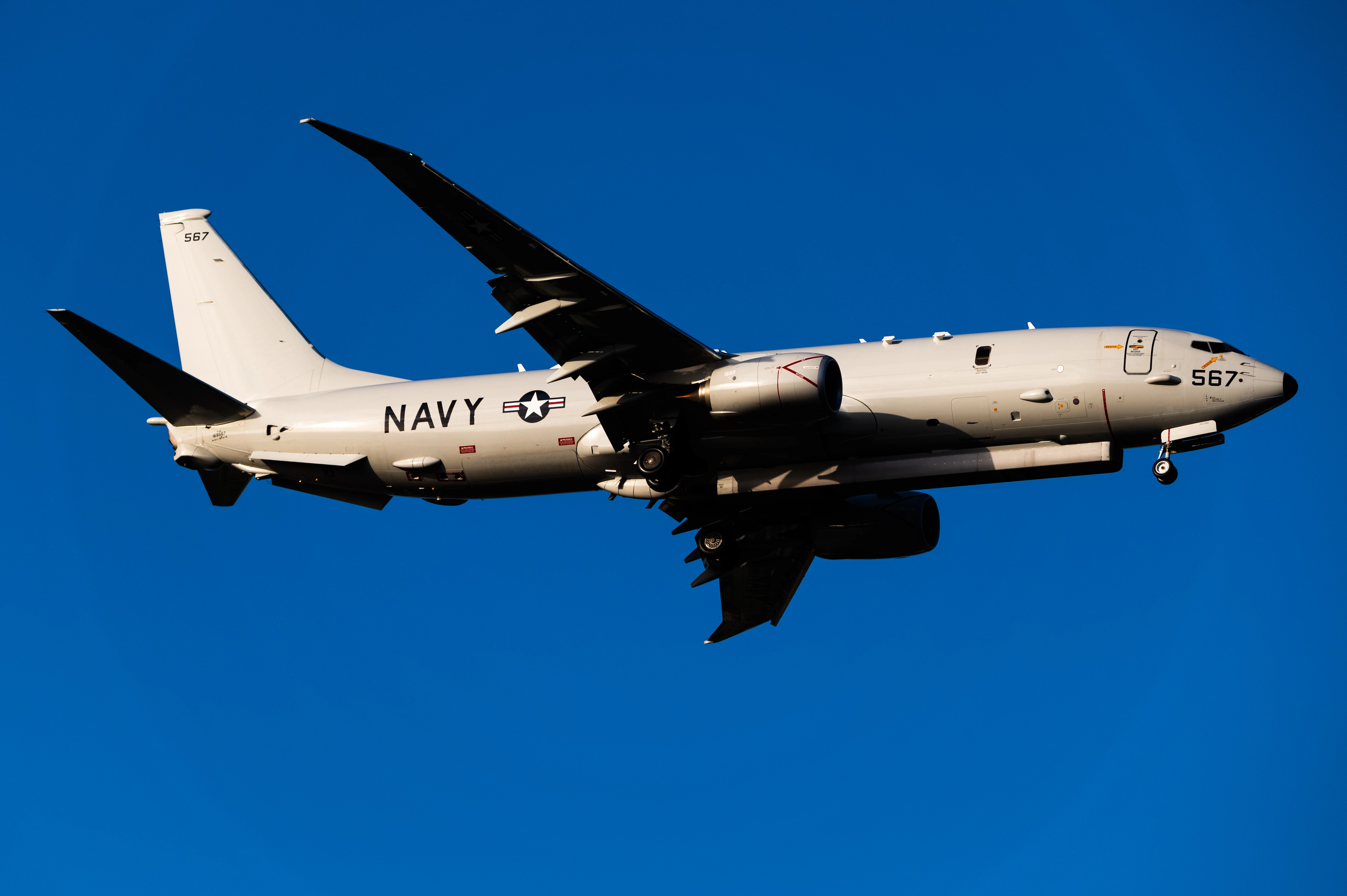

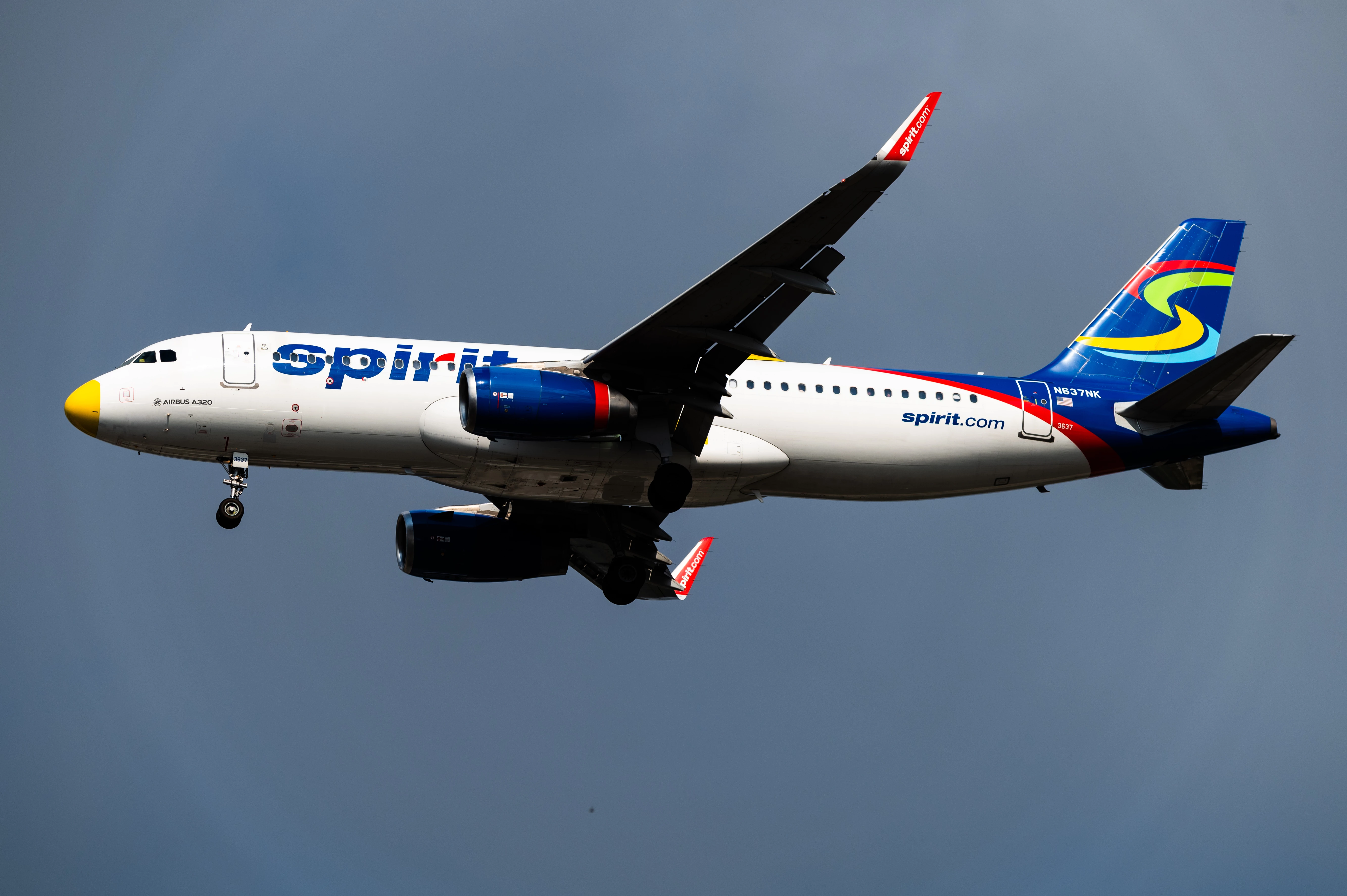

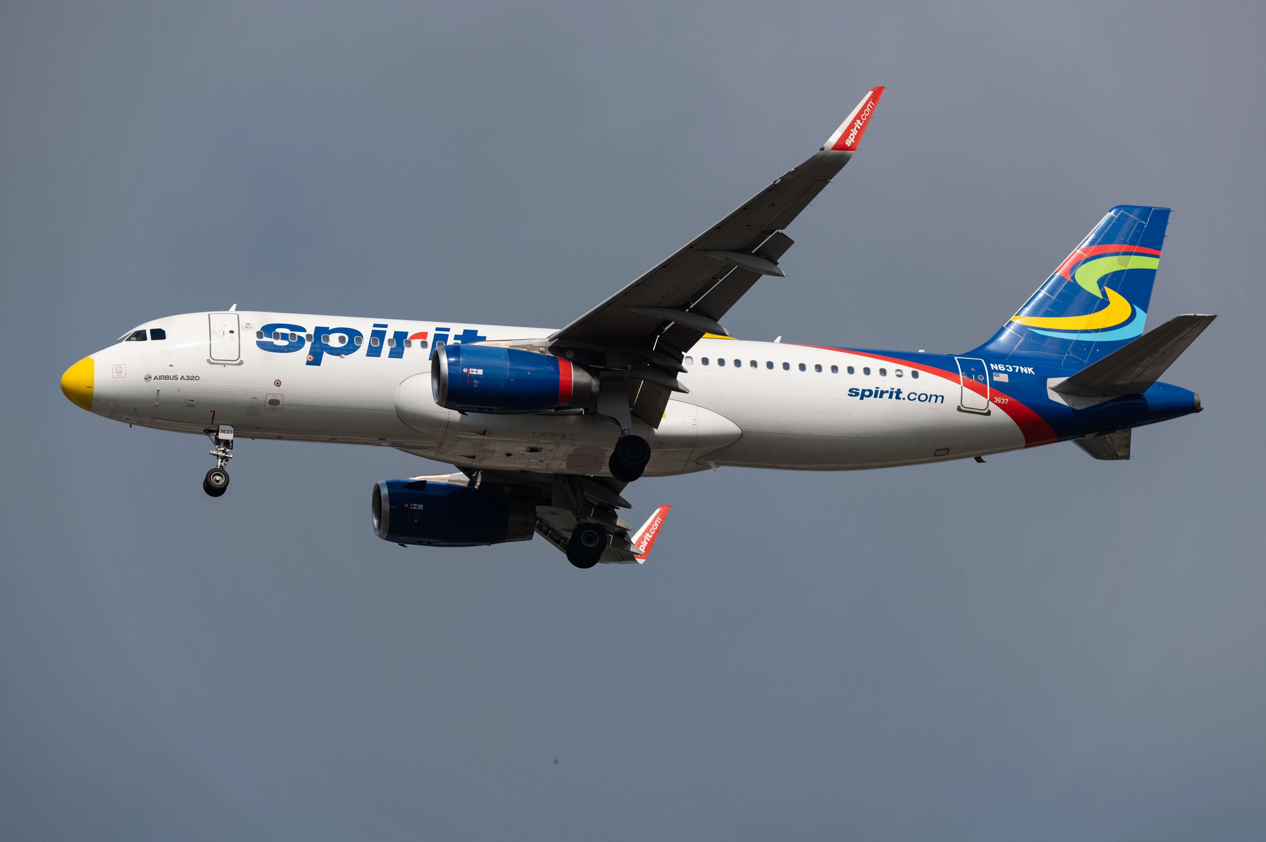

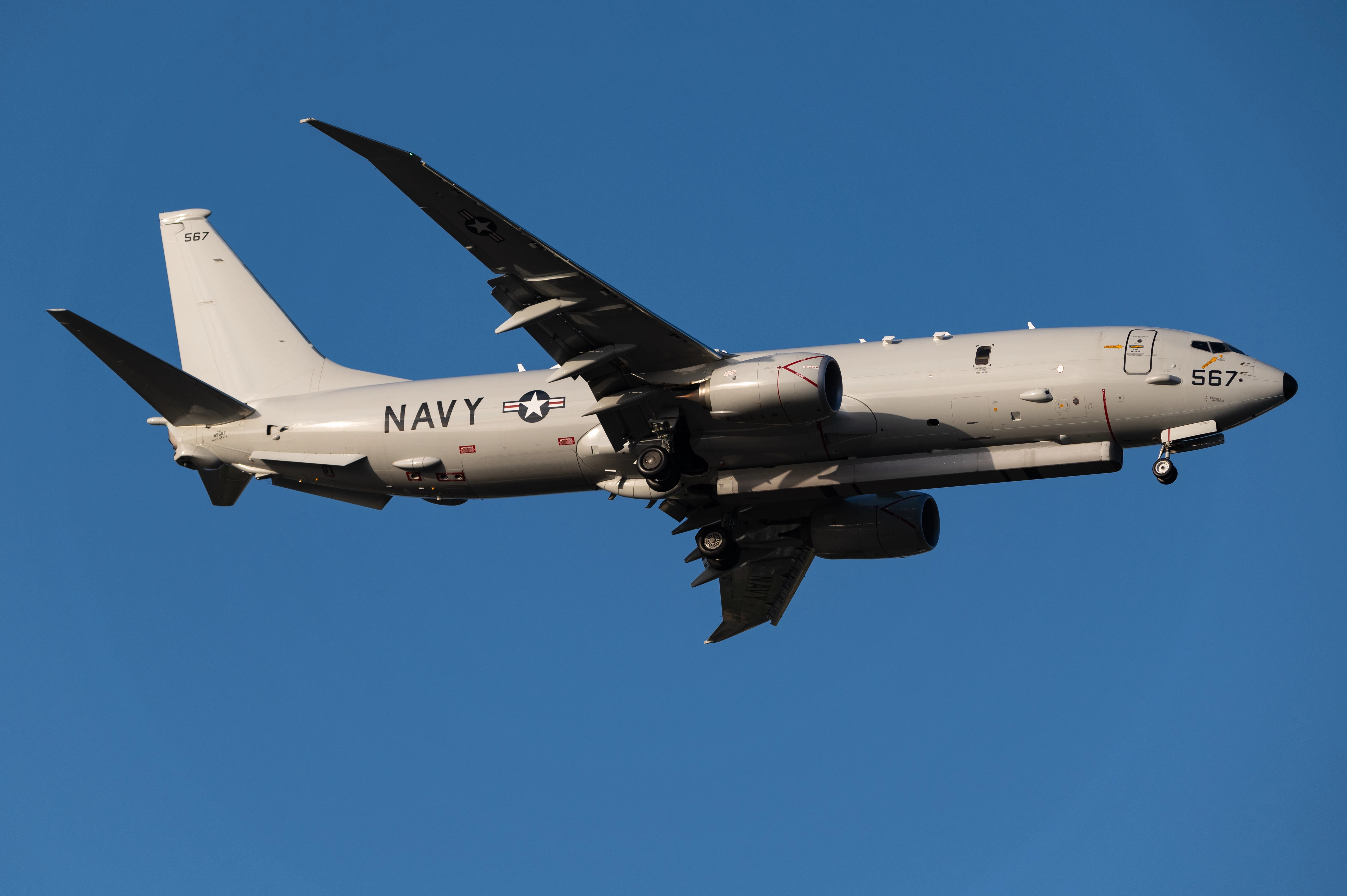

Pretty recently I have noticed a few of my images having a circular banding effect after turning on lens corrections. There a few distinct darker circles at the edges of the image.
This doesn't happen whenever the profile corrections are turned off and is only present in certain images.
The pics attached are the regular image plus an image with full contrast to show the banding. If anyone knows a fix, it would be greatly appreciated! Really don't want these images to have this issue.

June 28, 2024
The photos attached are the original and with contrast boosted to show the banding more clearly.
I have only noticed this issue recently, and it seems in some photos it is very faint and in others it is pretty noticeable. I have found it also only appears when the vignette control is turned on.
If it helps, I have a Sigma 150-600mm + UV Filter and Lens Hood. The banding is only visible with this lens and profile corrections, and not my 24-120mm with profile corrections.

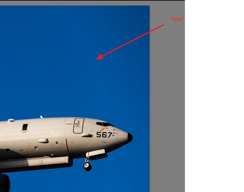

June 27, 2024
So a very faint (and in all pics presented) circular artifact such as might be a CPL filter issue, or a Lens Hood issue, or a lack of Lens Hood (glare/flare) issue?
If your pairs of screenshots are to indicate with and without the lens profile corrections are on or off, it appears that the correction is not creating the artifact but causing it to be more obvious.
