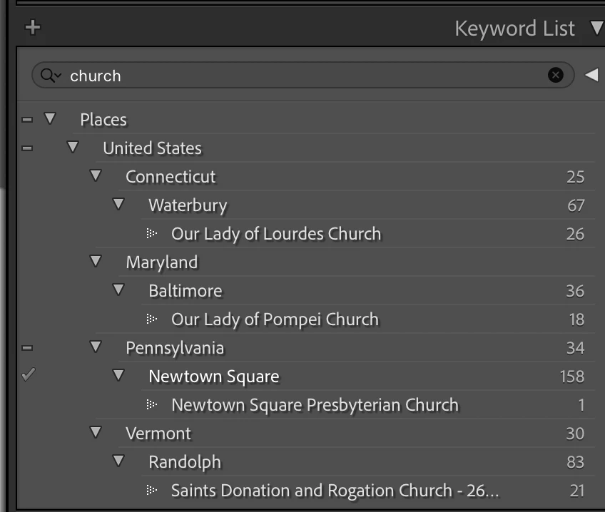

In your example, the photo has two separate keywords Church and Church < Buildings.    Normally, LR doesn't display the ancestors of a hierarchical keyword in the Keywording panel.  But if there are two keywords with the same name (e.g. "Church"), then LR will display enough of their ancestors in the hierarchy to distinguish them.
So this example shows your keyword list has two keywords, Church and Buildings > Church (theoretically, there could be a common ancestor to the two keywords, e.g. Landmarks > Church and Landmarks > Buildings > Church, but LR doesn't need to show Landmarks > to distinguish the two keywords). You can see the occurrences of Church in your keyword list by going to the Keyword List panel and typing "church" in the Filter Keywords box.

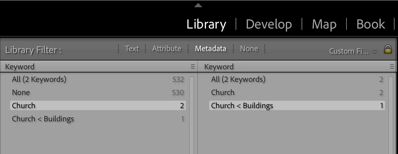

Here's a recipe for deleting the keyword Church from every photo that has both Church and Buildings > Church:
1. In the Navigator panel on the left, click All Photographs.
2. Do the menu command Photo > Stacking > Expand All Stacks.
3. If you don't see the Library Filter bar at the top, do View > Show Filter Bar.
4. Click on None to disable any currently applied filters.
5. Click on Metadata, and then add two Keyword columns:
6. Click on Church in the first column and Church < Buildings in the second column.  This shows all photos that have both keywords.
7. Selectd all the displayed photos.
8. In the Keywording panel, select Church and delete it.
9. If the keyword Church now shows a count of 0 in the Keyword List panel, you know it isn't assigned to any other photos and you can safely delete it.
If someone recommends using smart collections instead, don't -- the Metadata browser does exact match on keywords, whereas smart collections don't (unless you use a specific trick, which even then isn't perfect).

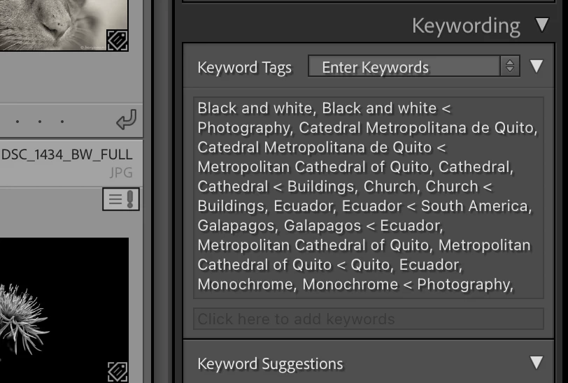

Lightroom Classic does support hierarchical keywords.
Where do you see "Churches<Buildings"??? Can you show us a screen capture of what you see (by clicking on the Insert Photos icon)?

Yes, I understand LR doesn't support hierarchical keywords, which is why I presume it converted my hierarchical keywords to those that I described.  See attached screen shot.  Thank you.
dj_paige
May 10, 2021
quote
I said the opposite. Lightroom Classic does support hierarchical keywords.
Please use the "insert Photos" icon to include your screen capture in your reply, as I do not download attachments.
