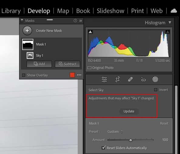

I can't recall whether it was 12.0 or 12.1. However, you should still be able to update the mask. The steps are:
1. Select the Mask Tool
2. Select a mask
3. Click on the 'Update' button as shown in attached screenshot
You'll likely need to repeat 2 and 3 above for each mask.
Note that the screenshot is for LrC 12.2. I can't recall if this is how it appeared in 11.5, but it should be similar.
