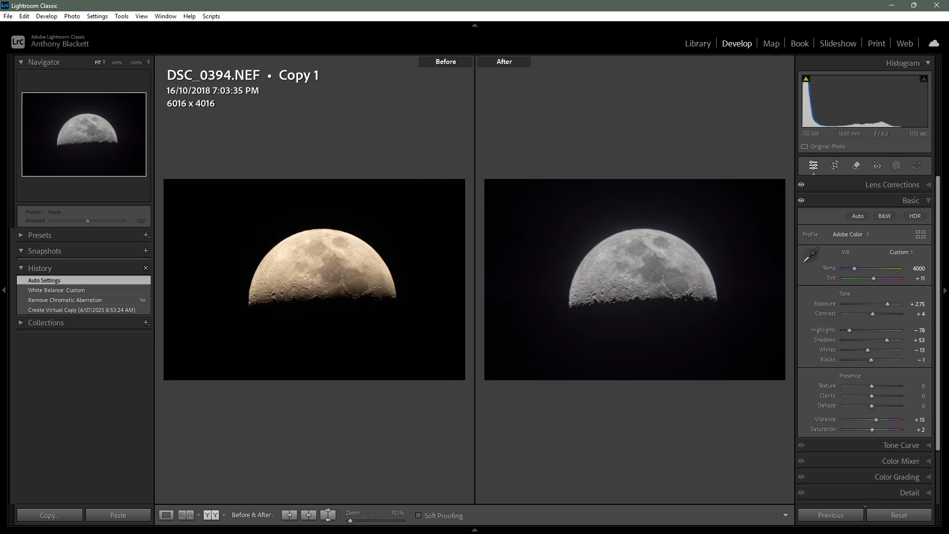

Here is a screen shot with Auto applied to a shot of the Moon that fills a large part of the original full frame of my Nikon D750.
As can be seen, Auto has no problem with this image, despite the relatively large area of near black. It has even brought out a bit more detail from the shadows along the terminator.
To quote @JohanElzenga, "'Auto' is not magic", so in some extremes it will fail to produce a good result. I also note for my example photo shown above, Adaptive Color fails miserably, grossly overexposing the Moon.

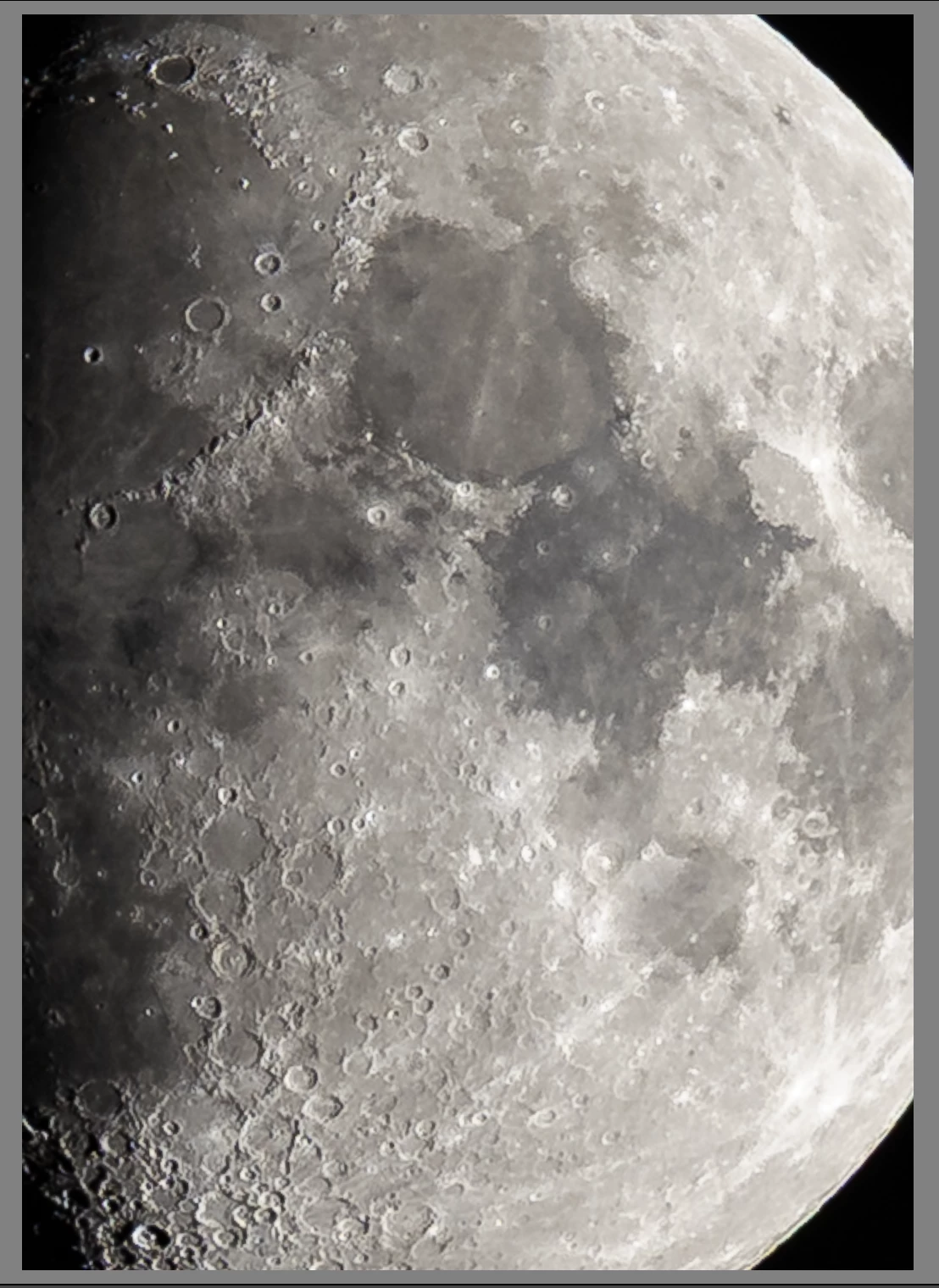

This is the crop before auto of the last and most narrow attempt, from the
after I didn't make a screenshot since it was pitch black.

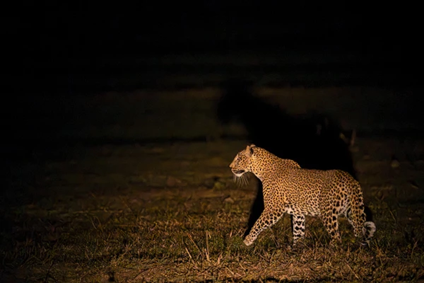

That does not surprise me much. 'Auto' is not magic. It's a rather simple algorithm and clearly not adapted to an image like this, that is unusual because it contains (and should contain) a large number of purely black pixels and a large number of (almost) white pixels with very few pixels in between. I see the same limitation when editing night shots taken on a game drive with a spotlight, like this one. Even the adaptive profile, which is way more advanced than the 'Auto' button, can't deal with this kind of shot and grossly overexposes it.

Thanks Johan, I know it's not magic, and I know very well how to deal with it manually, I've used Lr since version 0. But since auto became much better from version 8 on, I usually give it a try, and adjust where needed because that's just faster. If I don't like it, I revert. I was just suprised to see such a strange result. When I do ligtning pictures shot at night, it often doesn't do a bad job, and a bright bolt in the night is somewhat similar. I never had a frame go black with lighting, if anything, it turns it almost into daylight.
