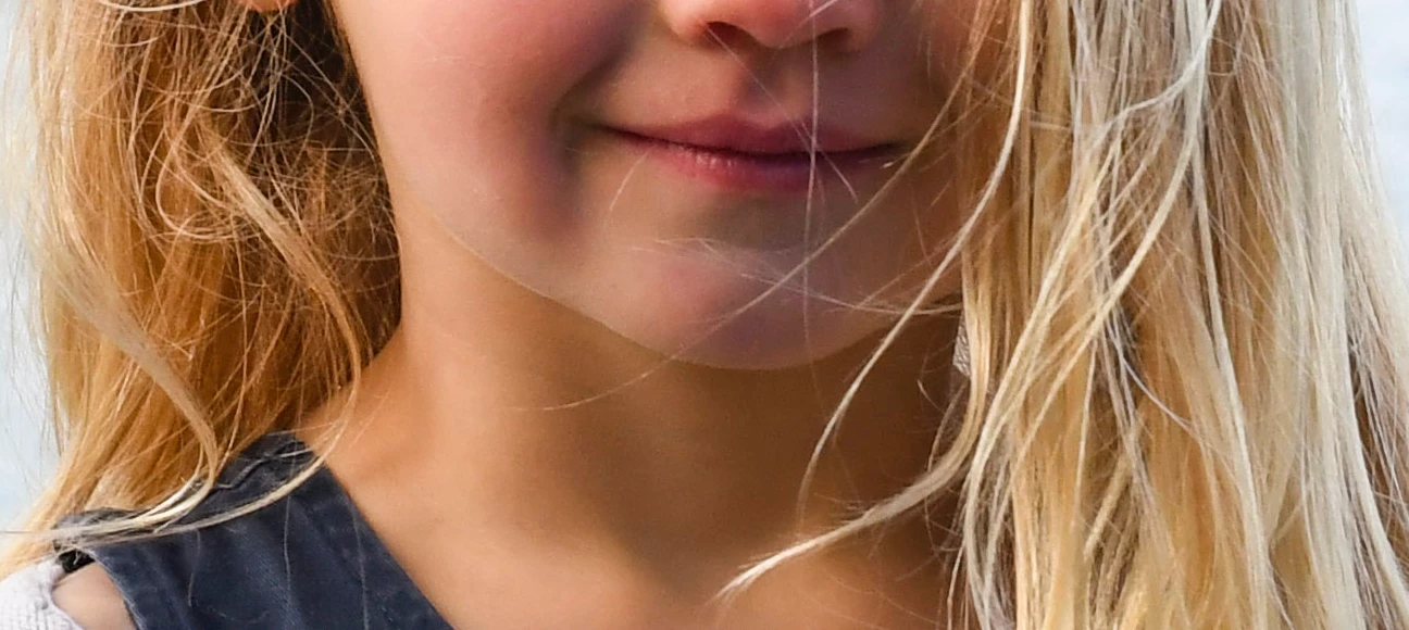

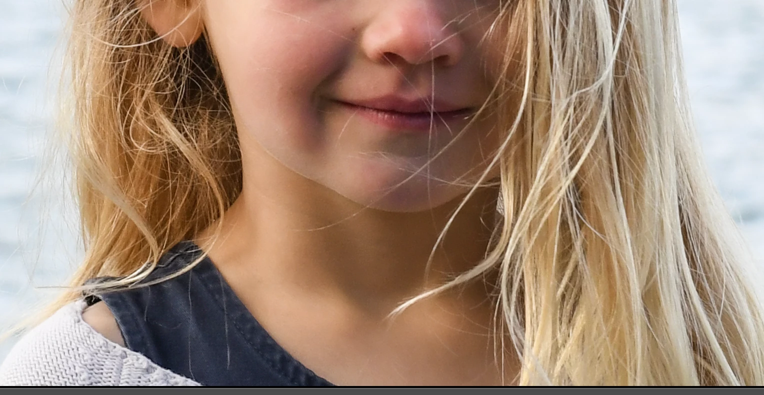

When I toggle to Library from Develop my photos have a red tone.  I have been using Lightoom since 2014. I have tried many different edits but cannot solve my issue.  Can anyone suggest a possible reason this is occuring and how one solves this issue.  Attached are 2 photos.  The one that is on the red side is the Library version of the Develop version.  Thanks!  Barry

In Lightroom Preferences I turned off Performance/Use Graphic Processor.  Voila!  Problem solved.  John, you did not hve the solution but gave me ideas of where I could look to solve the problem.  Many thanks hekping me prevent a total disaster with my photo shoot!
