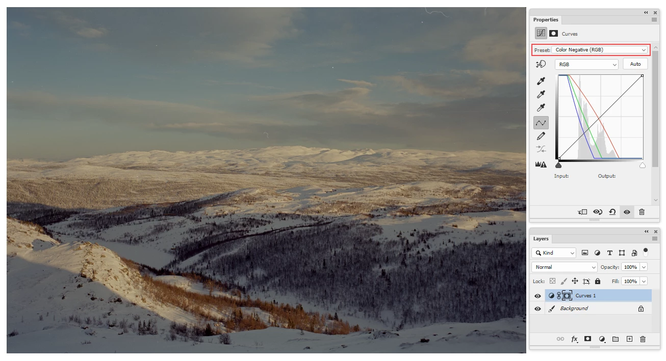

Inverting scanned color negatives is much better done in Photoshop.
The Curves adjustment comes with a preset for inverting color negatives, which most of the time provides you with a good basis for further editing. The image below is obviously too dark, but that's easily fixed. You can also add more adjustments layers if you wish, like Levels and Saturation.
If you can't get the colors absolutely right, you can tweak them with the HSL panel in Lightroom.
But before saving and closing the file, remove all dust spots and scratches, this is best done at 100% view. (which is the same as 1:1 in Lightroom)
For noise reduction, you would need to select both layers, right click them, and choose Duplicate layers.
The duplicated layers will then appear (selected) at the top of the Layers panel.
Right click them and choose Merge layers. Double-click the name of the merged layer, and name it Noise reduction or similar.
With this layer selected, go to Filter > Noise > Reduce noise. Set Preserve details to a high value, like 85 or more.
If one application of the filter at max strength isn't enough, you can run it several times. Work at 100% view.
