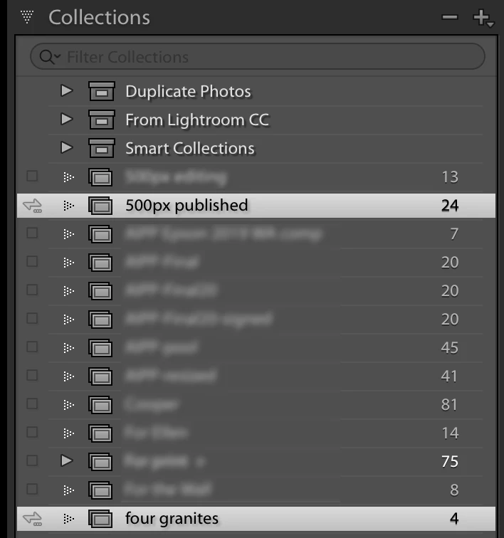

    Just to add to the conversation Shannon:
    I'm Syncing 2 Collections from the one Catalog as per the screen shot:
    You can probably see the active Sync icon on the left of both Collections.
    These appear in my LR Web app on both iOS tablet and phone . . .
