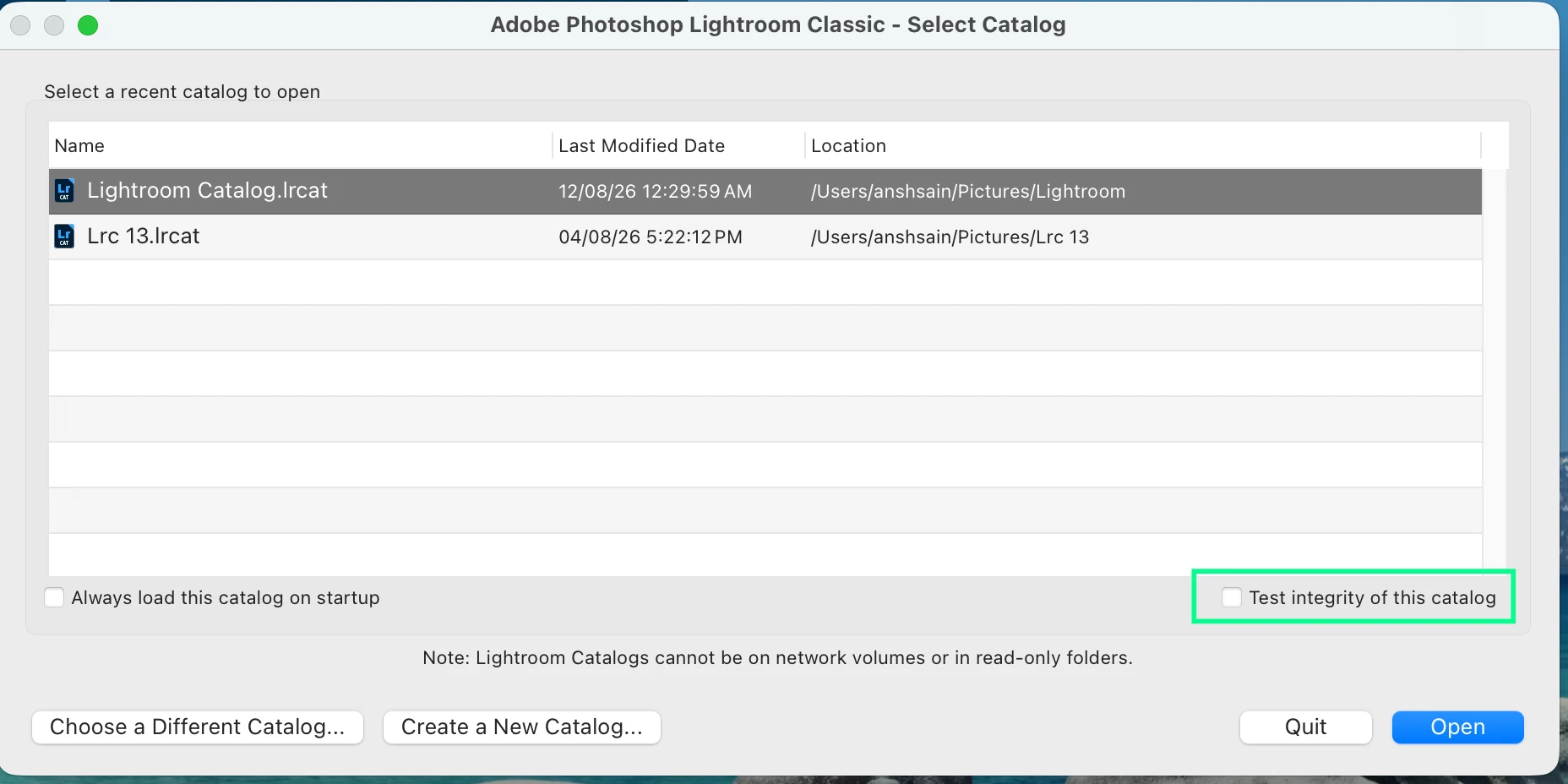

    1. After the restore, did you run a catalog integrity check to make sure the catalog properly reflects the current state of your files?
    • Hold Option while launching Lightroom Classic
    • Select Test Integrity on your catalog before opening it
