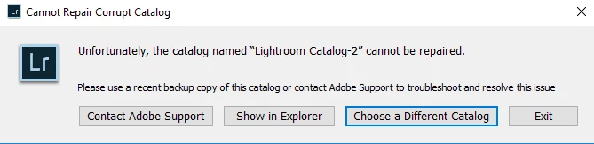

I have a problem with a LR catalog.
I am openening it, can see my last imported photos and then i have an error: LR encounted an error when reading a catalog file and need to quit. Then LR is shutting down and then trying to repair the catalog with no result.
Unfortunatly I have no backups. So how can i repair my catalog? It contains photoshoots for 2 years.
Thank you!

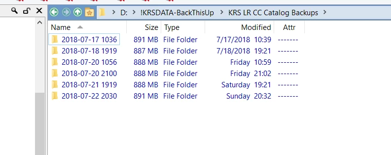

Do you have backups for your catalog?  If you don't know, search all your drives using the term "backup"
The backup folders that Lightroom creates look like this:
If you find those, pick the most recent one and open the folder. The file inside will be a .lrcat.zip file you will have to unzip. The unzipped file will end with .lrcat. Open that unzipped file in LR.
