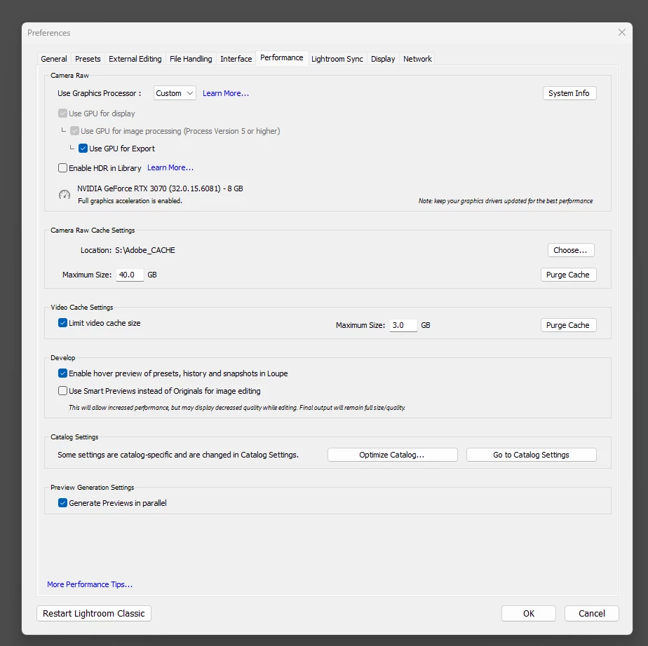

Can you also p[ost in a reply a screenshot of your LrC /Preferences/Performance?
example:

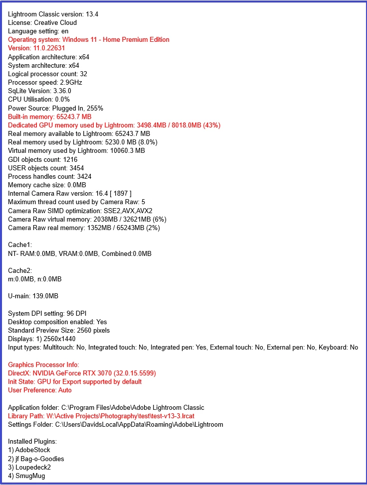

GoldingD
Sep 25, 2024 5:22 PM UTC
Please post your System Information as Lightroom Classic (LrC) reports it. In LrC click on Help, then System Info, then Copy. Paste that information into a reply. Please present all information from first line down to and including Plug-in Info. Info after Plug-in info can be cut out as that is just so much dead space to us non-Techs and it takes up vast amounts of scroll space making the reply less readable and less likely that others will bother with your post.
example:
