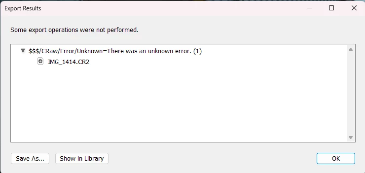

$$$/CRaw/Error/Unknown=There was an unknown error. (1)
Hi all, I hope someone can help.  Since the upgrade to V13, I have been getting the below error when I try to export an edited photo.  I've tried on earlier photos, and ones imported since upgrade, and issue with them all.
Unedited photos export fine.
I just updated to V13.0.1 and still have the issue.
Hoping someone can advise!  Not sure if I need to completely change my export settings, but I'm exporting to JPEG, with Adobe RGB (1998) as I usually do.

I agree that turning off the early access feature of lens blur let me export the photo. Not idea, but lets me continue.

I found this thread after having the same problem. I've got a NVIDIA graphics card and toggling  the "Use graphics card for export" option off in the prefrences allowed me to export with the blur still applied.
Therefore, I imagine that, at least for me,  it's a graphics card driver/Lightroom Classic issue.

I have recently encountered the same error, turns out it was the Blur feature blocking the export. As soon as I turned that off, it exported fine.

Doesnt seem to be.  The answer to me was that my computer is too old...  luckily I had already ordered a new one but not exactly an ideal solution.  I've rolled back to V12.5 for the meantime.  No issues now.

I solved the same problem when exporting equilateral 360 images edited in this way: I exported in DNG format, in this way the develop settings were also exported, then I opened the DNGs in LR (not LRc) and exported JPEG without that error

I contacted the support yesterday because of this issue. They said its a bug and will be fixed ASAP. Now we have to wait and see 😊

Mine seems to have fixed itself.  I tried going back to V12, but then it wasnt working at all...  so back to V13, and tried again yesterday, and it now exports fine.  I hope yours will do the same.
