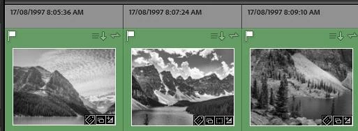

I have a problem with dates, because LR seems to want the precise date and time of every picture,
If you have scanned the images they will already have different 'Time' (HR:MM:SS) and Capture date from the scanner.
You can simply change the metadata (Menu: Metadata>Edit Capture Time) for Year and Month only. The exact hour need not change! You can change multiple photos (eg. a folder from one negative strip of images) and you have the correct YY:MM: and the scan time (that is basically irrelevant) HR:MM:SS.
I also rename the scan files with a Date..format, and also store the files in folders with Date/Location names.
This works for me.
Screen-clip shows photos with Capture date changed but 'Time of scan' as scanned!
Capture time Change
