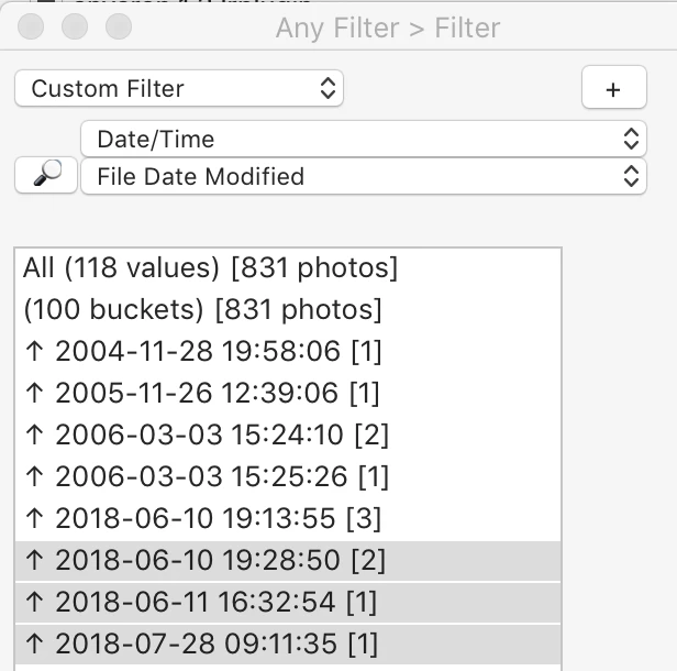

I released a new version of Any Filter that lets you filter and sort by the file modification date:

johnrellis
February 12, 2020
"why is it not possible to check the modification date of the file inside Lightroom? Maybe I'm just missing something? ...Is it possible to sort files by their modification date inside lightroom?"
You're not missing anything -- LR doesn't have that ability.  I think that Adobe long ago decided to focus on photo metadata stored inside the photo according to industry standards (EXIF. IPTC, XMP).  Since file creation and modification dates maintained by the operating system are in general fairly fragile, with many applications and utilities changing them inadvertantly, Adobe has focused on workflows that use the industry-standard metadata instead.  (That's not to say your workflow or needs are "wrong", just that Adobe hasn't viewed it as something most users would want to do.)
It's been on my list to add file dates to my Any Filter plugin, which would let you search and sort by them. I have to put out a new release in a couple of days to accommodate LR 9.2, and I'll add file dates then.
