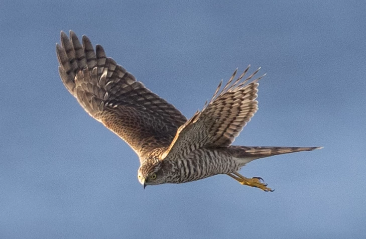

I am attaching three screenshots of the same picture.

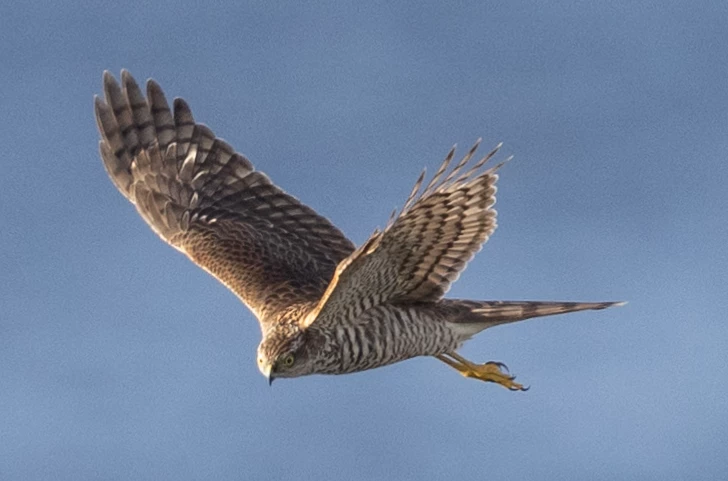

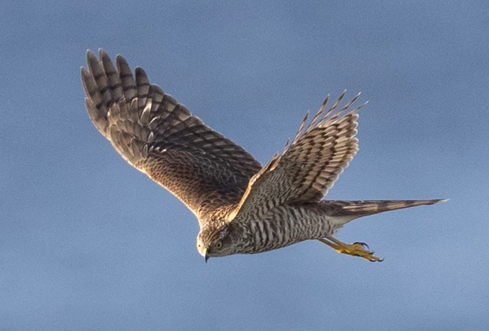

The first one is the original picture shown in 100% view. The second is the same picture that is cropped also in 100% view. The third is the same as the second, but with GPU turned off.
You can see on the head area and tip of feathers that the second picture is a bit less sharp than the first one. The third picture is sharp again.
Without any edits - just 100% view in Develop mode:
Cropped image in 100% view in Develop module:
The same picture as 2) but with GPU turned off:
