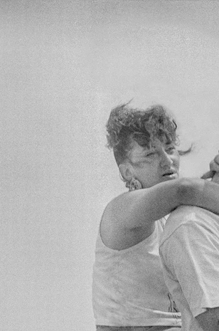

Cross hatching appears in image when exported as tif or printed but not visible in Library or Develope module when viewing in LRC. The more sharpening I use the stronget it gets. I normally use 50 sharpening, Radius 1 Detail 25 on all my prints. The file is a scan from a negative on an Imacon scanner and I have printed many, many other similar negative scans and have not had this issue. This particular image has had a lot of adjustments made to it, dodging and burning. I am using  Mac book pro OS Ventura 13.4 and LRC  13.2. I have tried it with the graphics processor on auto  or off.

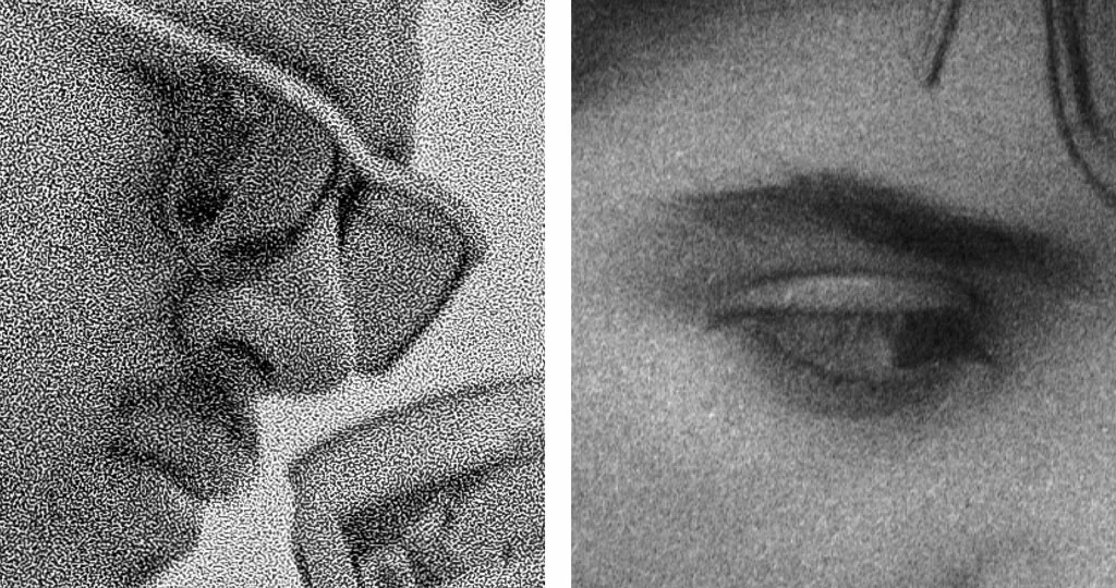

To illustrate some of the concerns here: On the right side of the picture below is a detail from my own scan from typical black-and-white negative film. If you compare the two, you can see that in the scan on the left, somehow many of the intermediate gray tones are missing, and there is a prominent stipple type of pattern. I also looked at a scan of a portrait on high contrast black-and-white slide film and even that isn’t as posterized as the image on the left.
When you re-scan the image, specifically check the bit depth setting, because scanning software terminology can be confusing and misunderstood. What you are looking for is to save a grayscale image, and you want to verify that whatever the setting is called, it’s saving at 8 bits per channel or 16 bits per channel. Some scanning software has an option labeled “black and white” which literally means black, white, and nothing in between (one bit per channel, or on/off). That 1 bit/channel setting is intended for text/line art documents, not photos, and if used on photos, the scanning software may translate gray shades into literal black and white by applying a dither pattern. The “cross hatching” you see does suggest a moiré pattern caused by pattern interference. I am able to see the moiré pattern in your original file on my display. (How visible a moiré pattern is depends on the difference between the frequencies of the pattern in the pixel grid of the image and the pattern in the pixel grid of the display or printer, so the pattern may be more visible or less visible depending on the display and printer.)
By the way, do you know what the film stock is? Is this the same type of film you’ve scanned before, or is this a special graphic arts type of black and white film?

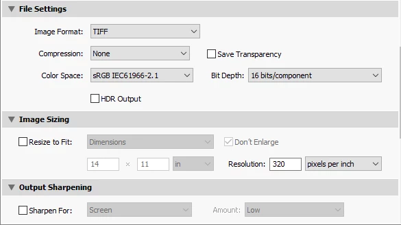

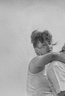

Thanks for sharing. I was curious so loaded your DNG in LrC 13.2. I use a calibrated Asus Pro Art monitor and can't see any moire/cross hatching in either LrC or in the exported TIFF when viewed in Windows Photo Viewer.  I'm not sure if Photo Viewer is showing the TIFF file or embedded JPG preview. I mention this because depending on the viewer, you may be viewing the embedded JPG preview in the TIFF.
In case it makes a difference, here are the EXPORT settings I used
Here's a screen grab of approximately the same as you posted. This was taken on a cheap ACER secondary monitor but again, no moire.
