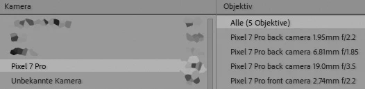

Interesting that you're asking that, Johan. I checked - the metadata browser of the Library module of LR classic identfies the Pixel 7 Pro as one camera with for different lenses (which are then labled cameras). Here a screenshot from LR (German version, "Objektiv"= Lens):
That could explain why it's not possible to create user profiles for the four different cameras (and sensors) according to LR Classic's logic here - but it doesn't explain why it is not possible to add any custom profiles at all.
Kren
I think it does explain that. The XRite software probably saves the profile with specific camera information, for example with what Lightroom shows as lens information. That means that what Lightroom considers lens metadata might be what the profile uses as camera metadata. Which means that none of the profiles match the 'Pixel 7 Pro' camera metadata that Lightroom sees. Or do you mean you can't create a profile for a totally different (normal) camera either? That is not my experience.
