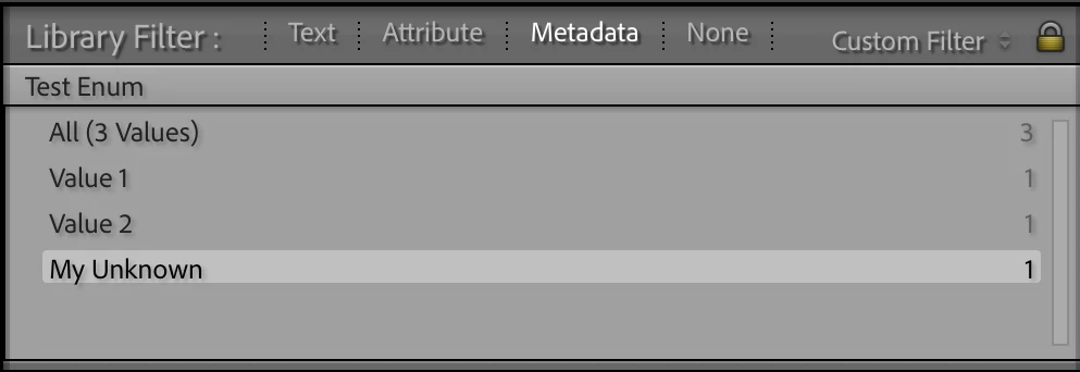

@johnrellis
More problems.
I set the second value to nil
In the filter all photos that don't have "value 1" appear with the title associated to that nil e.g. "No"
In the metadata panel they also appears as "No"
• In the Metadata panel I selected 2 photos, one with value 1 and one with nil
At this point is not possible to set  all selected images to nil via the Metadata Panel because LrC thinks they already are at nil.
My solution: use "" instead of nil.
Metadata Panel will NOT show < mixed > state but at elast it will allow to set all images selected to ""

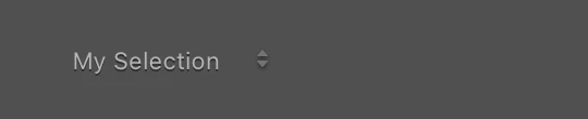

It looks like the Metadata panel never shows "< mixed >" for fields of type "enum".  Instead, when the values in the selected photos are mixed, it either shows no value at all or it shows the enum title that's been assigned to "value = nil".
As a test, in the Metadata panel I set IPTC >  Copyright Status to Copyrighted for one photo and to Public Domain for another. When I select both photos, the panel shows Copyright Status: Unknown:
I defined a plugin field of type "enum" with two values, Value1 and Value2. When I set one photo to Value1 and the other photo to Value2, the All Plug-in Metadata tagset shows nothing:
I modified the definition of the "enum" to include a third value:
{title = "My Unknown", value = nil}
Now, when I select the two photos (with Value1 and Value2), the metadata panel shows My Unknown:

johnrellis
Mar 13, 2025 7:15 PM UTC
[This post contains formatting and embedded images that don't appear in email. View the post in your Web browser.]
"Perhaps I can set the second value to nil instead of "". But it I am not mistaken nil is not searchable."
In my quick test, the Metadata panel and smart collections can search for nil enum values:
