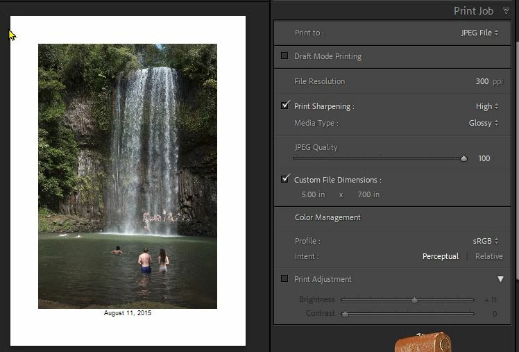

    You could use the Print Module, but there are several limitations-
    1) The [Date] does not appear 'ON' the image. It appears below on a border.
    2) [Print to JPEG] does not use the original Filename but instead uses the {Folder name- Sequence}

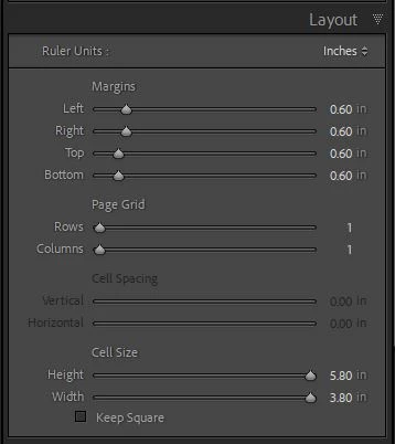

    3) You can define 'inch' border margins (calculated from ppi and pixels)
    Set your PPI and Custom File Dimensions (5x7inch 300ppi = 1500x2100px) in the Print Job panel-
    Set your margins in the Layout panel- (Mine shown in my clips are not 50px!)
    Set the Photo Info for [Date] in the Page panel-  (Presuming that LrC has 'Date' recorded in metadata for photos.)
    Regards. My System: Windows-11, Lightroom-Classic 15.3, Photoshop 27.5, ACR 18.3, Lightroom 9.3, Lr-iOS 10.4.0, Bridge 16.0.3 .
