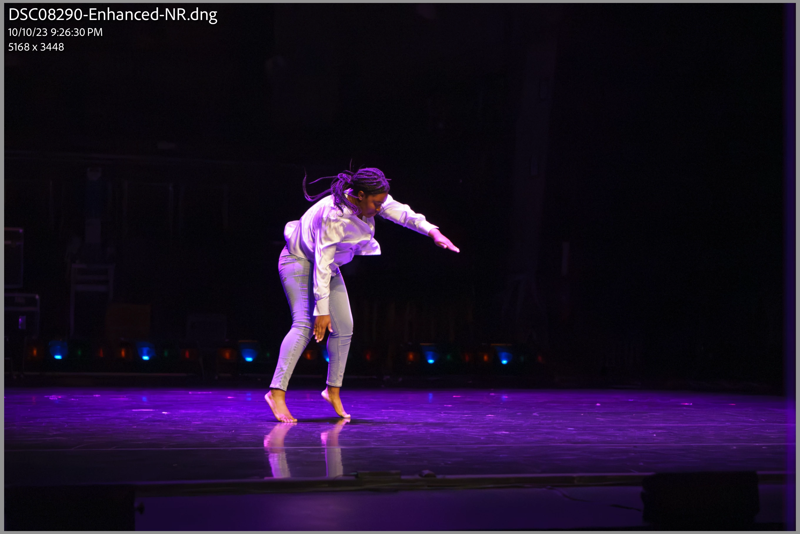

Denoise creates a weird light band on right edge of photo
When I run Denoise, a weird blue-ish, purple-ish streak appears on the right edge of the photo. Please forgive me if this is something obvious that I've done terrible wrong.
I'm using Lightroom Classic 13.0.1
I'm on a Macbook Pro, 2017 model running Ventura 13.6
Thank you so much—happy to provide more info and examples. Before and after below.
6 replies

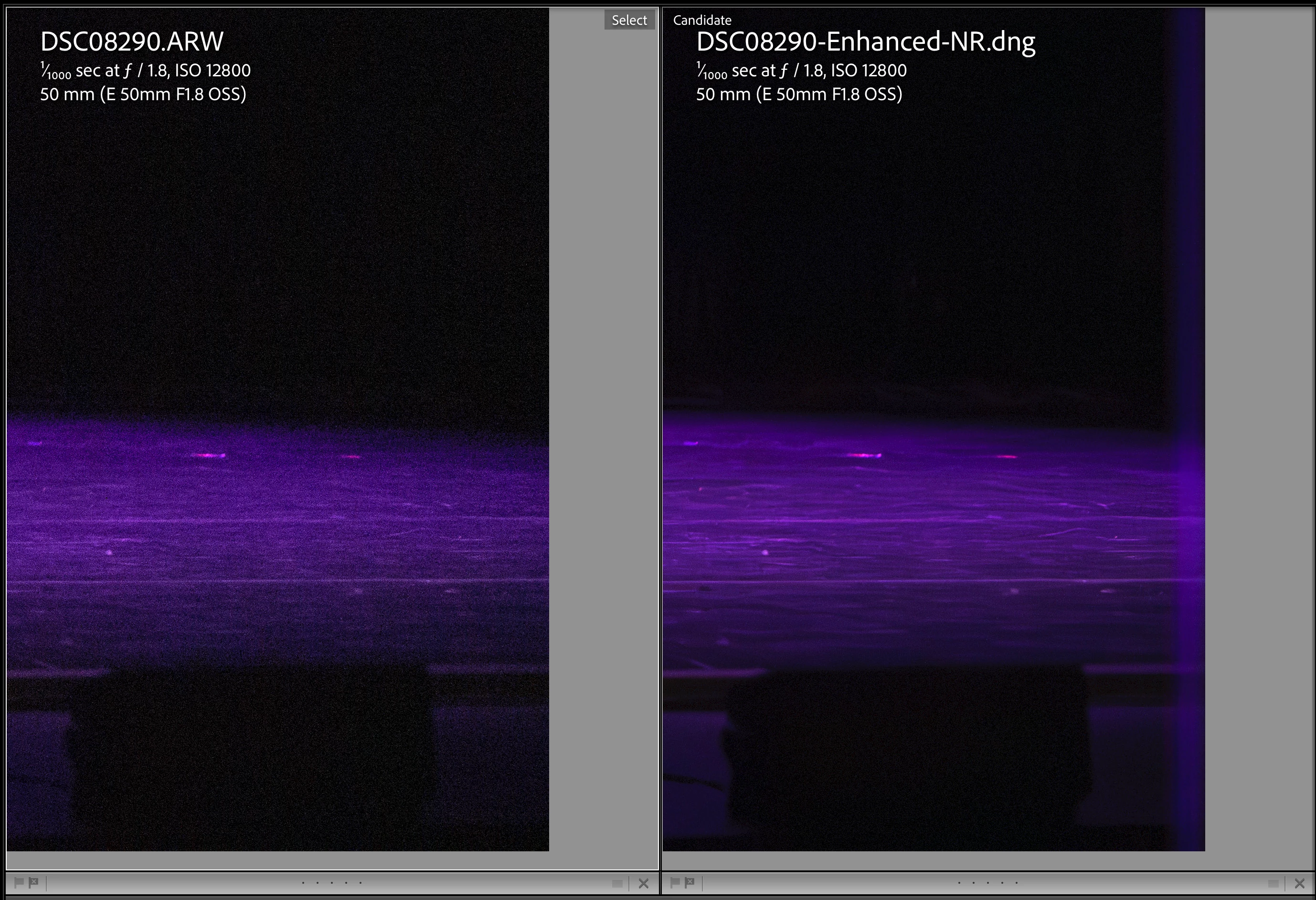

This file gives me a blue artefact on the right hand side too after running enhance (strength 50). Clearly visible in the screenshot below. So it is not your computer I think. It is clearly caused by the enhance feature as it is not present in the original (second screenshot). Very strange.
P.S. enhancing this image takes about 15 seconds on my M1 Max MBP. I am sure it takes many minutes on your machine.
