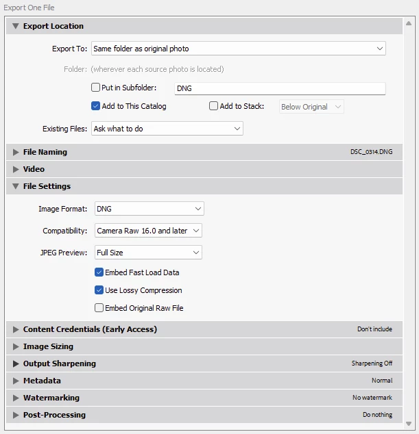

I exported an edited NEF VC to DNG with these settings in the Export Dialog:
The Add to This Catalog option saves the extra Importing back into LrC step.
The exported DNG had all the edits that I made, including Denoise which I applied before the Export. The NEF from my Z8 is 47.2 MB; the exported DNG is 11.2 MB. I removed the Denoise and Exported as DNG again; this time the DNG without Denoise is 6.5 MB.
So, the question to be answered is what are you doing that is different?

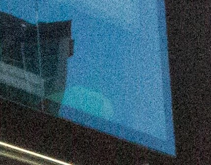

1) Original (High ISO) image.  (Original 21.6MB is a converted DNG from a CR2)

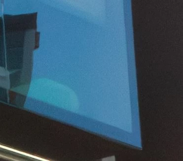

2) Denoise applied to the original-
