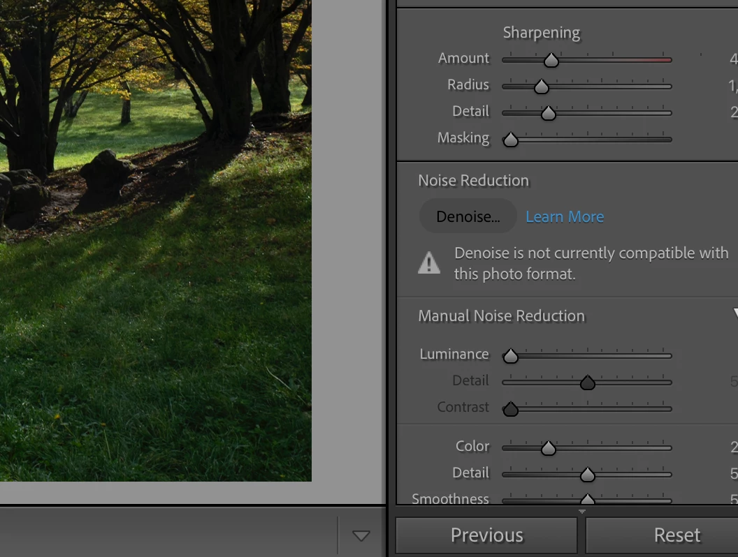

Denoise was working 2 years ago, but after some updates not working for cr2 (RAW not sRAW).
So when denoise was first added, it was working. After a few updates it stopped working. I could understand if they would use a different image model that would require more GPU power, but I get the error that the file format is not compatible.

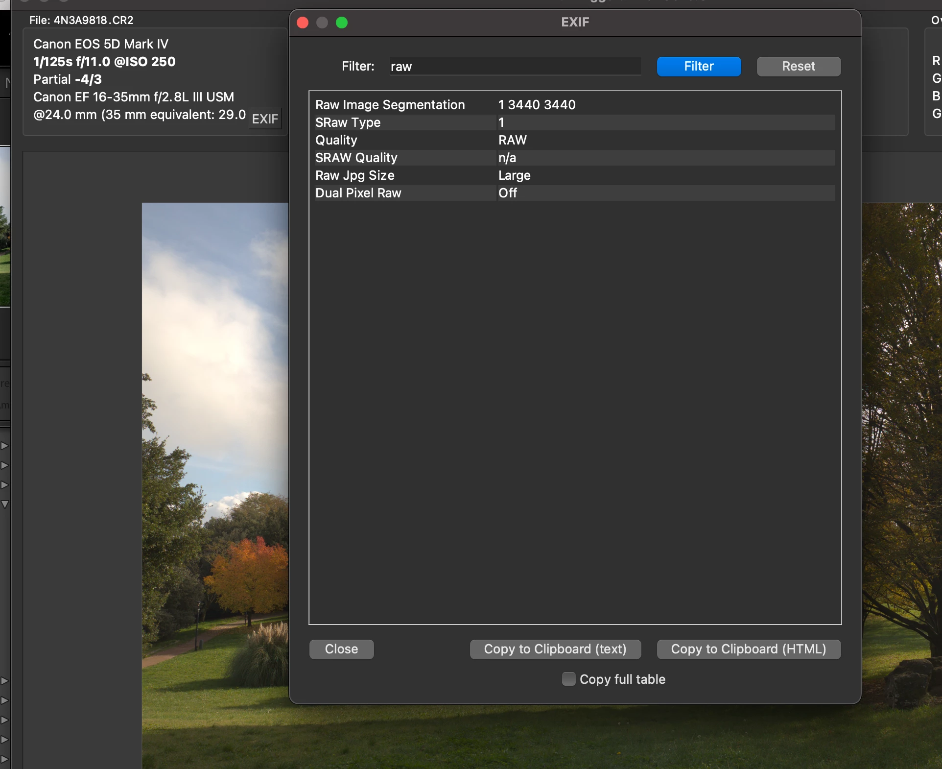

---- ExifTool ----

Razvan5E88Correct answer
Nov 13, 2025 9:23 AM UTC
Since I do not own a Canon, please tell me what it means in the Exif fields when there is the number 1 next to SRaw Type?
I updated again to the latest version (I downgraded a while ago because the version didn't work). This latest version, works, so case closed.
5 replies
dj_paige
Nov 12, 2025 1:45 PM UTC
So please tell us in words what happens when you try to perform Denoise. Please be specific and detailed.
PS: I cannot see your screen captures (or anyone's screen captures). Please use the "Insert Photos" icon to include screen captures in your reply.
