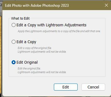

If you [Edit in Ps] a TIF or PSD- then you do have options:
And to re-open the TIF or PSD while preserving any layers you might have in the file, you must select either [Edit Original] or [Edit a Copy].  (Note: "Original" in this context is the new image previously created by Ps. Not the original raw file.)
