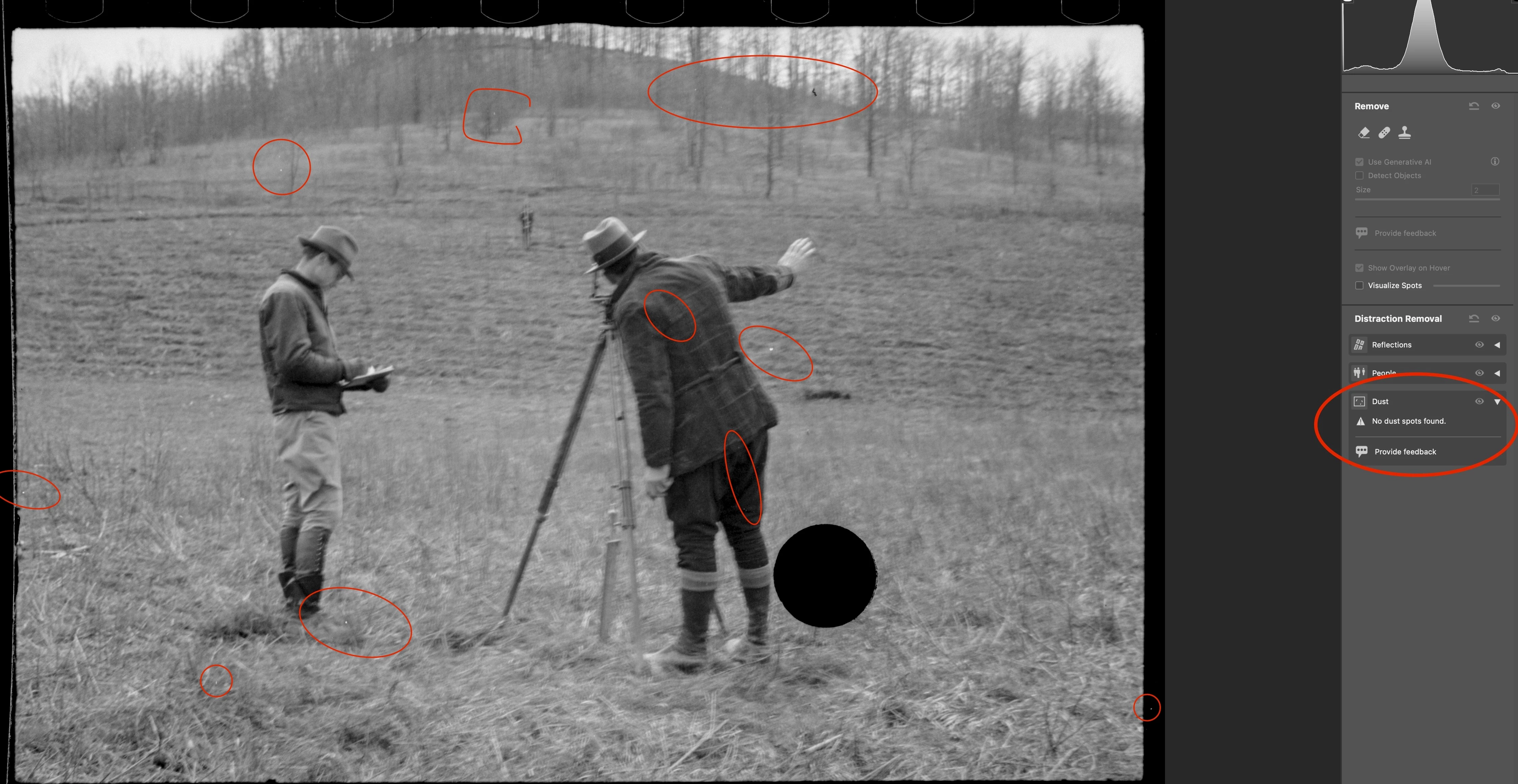

Nov 11, 2026 4:49 PM UTC
Does not work on JPG images.   Got 3 0ut of ablot 70.
Also… a Slider to adjust the amount of removal.
I’m using it to remove dirt on old Photos for a Author.

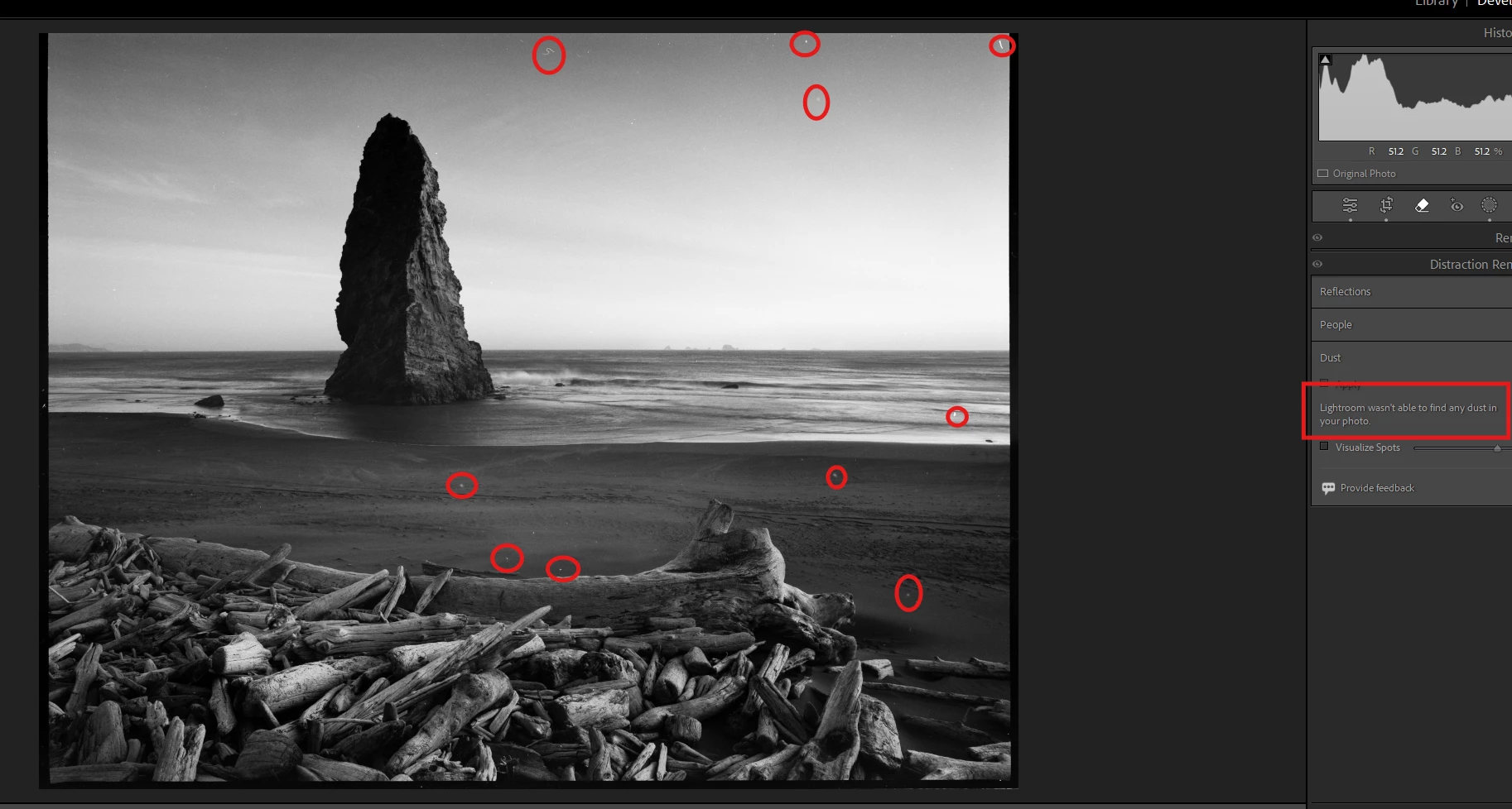

I just worked on a bunch of images from snowy days and had to remove a lot of spots.  But, these were more from snow/rain being on the front lens element, rather than sensor or scanned dust.  The ‘visualize spots’ feature didn’t pick them up.  Would that be expected or should visualize spots have seen them?  They were pretty blatant circles that were darker than their surrounding area (particularly skies) but much bigger than even dust spots would be.
Anshul_Saini
Nov 11, 2026 6:33 PM UTC
Hi ​@Nadeem28230335k4xr,
Thanks for bringing this up!
Visualize Spots is intended to help identify smaller spots, such as sensor dust. Larger marks caused by snow or water droplets on the front lens may not be highlighted in the same way.
Could you share an example image showing the spots that Visualize Spots missed?
Also, have you tried Distraction Removal > Dust on the same image? If so, did it detect any of those marks?
It would be helpful to compare how both features handle the same image and determine whether this is an expected limitation or something worth investigating further.
Thanks for your help!
Best,
Anshul Saini
MNauman
Nov 11, 2026 6:40 PM UTC
Here you go.   I don’t know how for sure but my guess is scanned in. I’ll check.  My client is in Europe.
Lightroom Classic 15.6

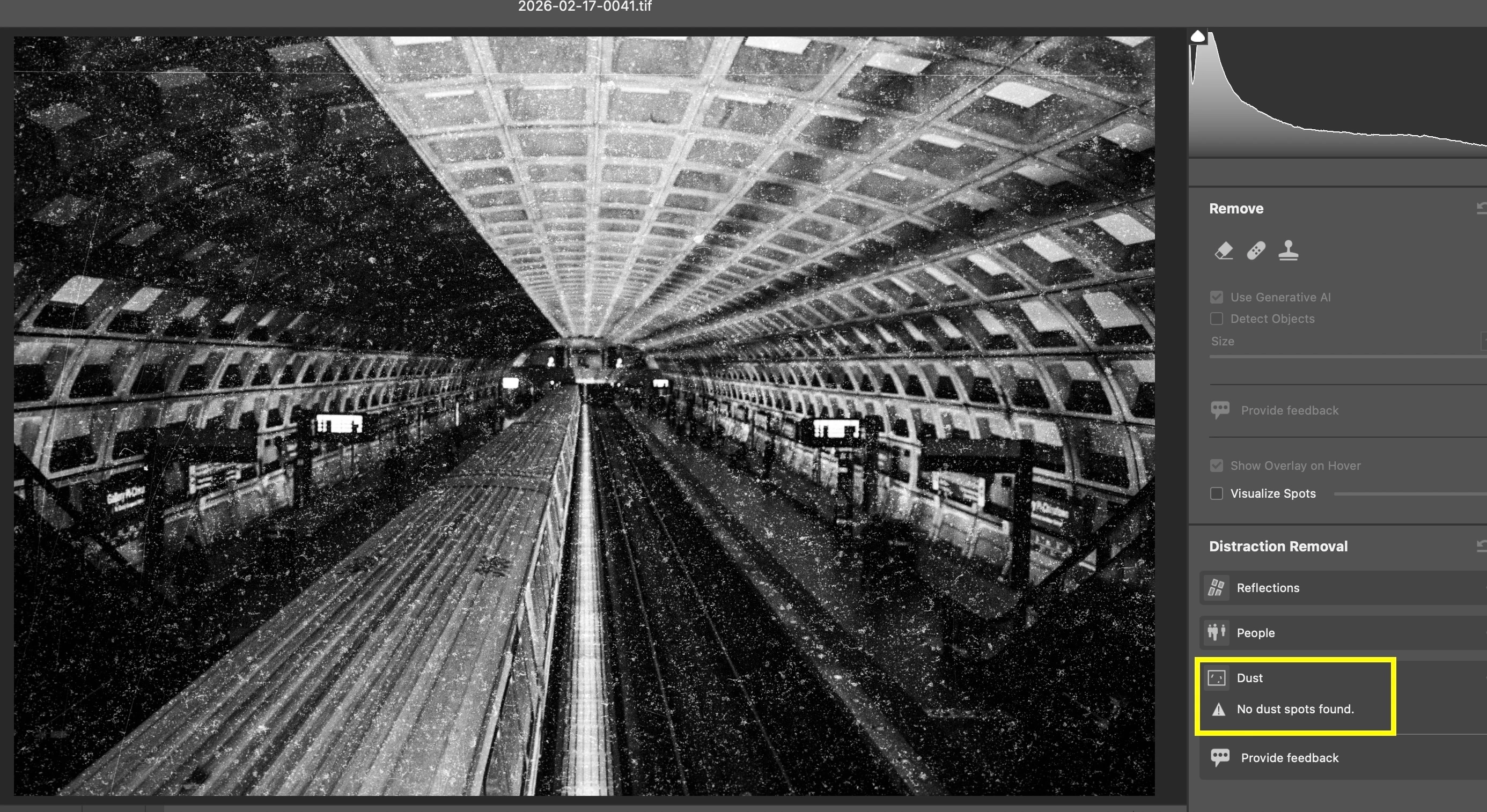

Nov 8, 2026 2:48 AM UTC
Dust removal in Bridge not effective on scanned color negatives.  No perceptible change.  Keep working on this, you have a long way to go.
