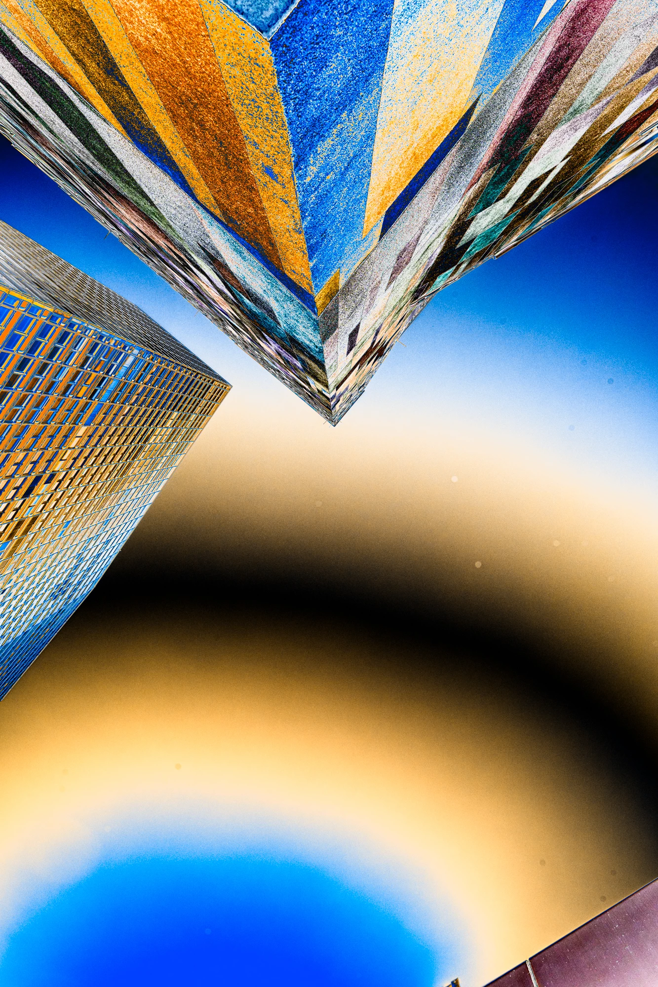

dongz14409238
Nov 2, 2025 8:57 PM UTC
great feature, I had always headache while seeing the photos from clear sky because there are very often that dusts were also captured. However, use it carefully. There might be circumstances that this feature also generate ghost effects.
Here are two examples shown before and after:

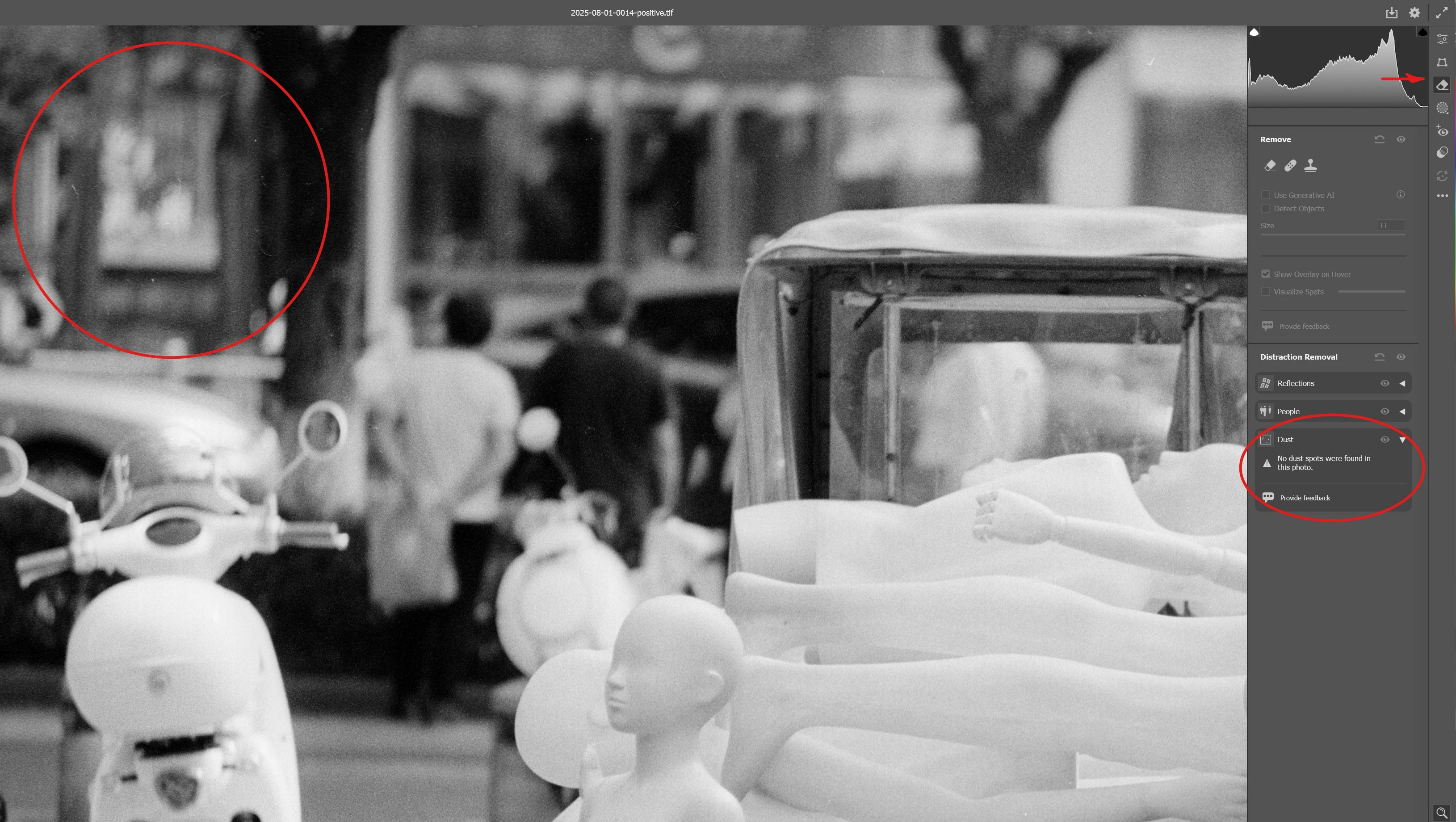

Nov 1, 2025 3:27 PM UTC
AI Noise reduction + Dust removal does not work well together.
Nov 1, 2025 4:15 PM UTC
@jrwilander the orange/yellow button on upper right (under histogram) needs to be press.  See what you get then.
Nov 1, 2025 7:12 PM UTC
Whoops, thank you looks great now ❤️
