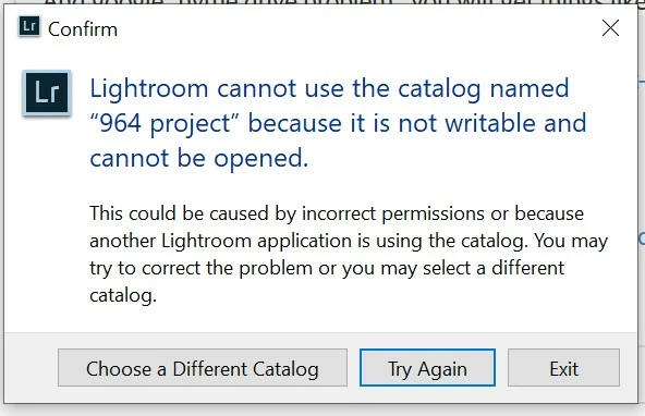

I can open and create catalogs on my two sata drives C: and F: however LR will not open or let me create a catalog on my two nvme drives which are installed with a pcie adaptor. coincidence? 😧 and E: if I right click and run the lrcat with LR Classic I get an unknown error-retry box. I have over a dozen catalogs over these two drives and none will work

    Thank you for your suggested reading however; I have come to the conclusion that my hardware is fine and there must be an issue with LR being able to read my catalogs after I migrated them to the nvme drive.

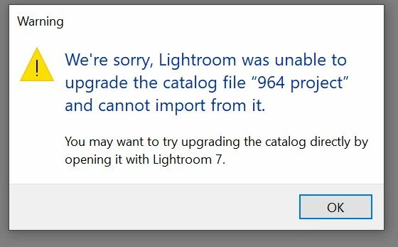

    I can read and write to the nvme drives in Photoshop, office etc. no problems. I did discover I could create a new catalog on the two drives in question. When I tried to import a small catalog to the newly created empty catalog LR said that catalog must be upgraded. after selecting that option LR then offered:
    Well, I don't have 7 any more so I tried again to open in 8.4 with the following results:
    I Then downloaded this project from my backup (only a few images) to my nvme and LR not only upgraded the catalog but opened it as it should. It appears there is something corrupt that LR doesn't like in all the migrated catalogs.
