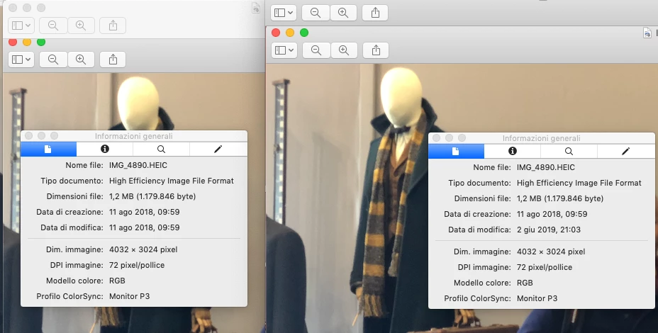

I'm trying to import photos from a directory, but I've noticed that isn't working properly. LR doesn't catch duplicates even if they are  the same file, same size, same capture time: I've attached a screenshot comparing the photo that exists in LR and the one which it is trying to re-import. What's wrong?

    Are these 2 images in the same or different folders? If in different folders, which they must be as 2 files with the same exact name can NOT be in the same folder, then that is part of your problem.
    LR sees them as different files not only because of the modify date/time but also they are in different folders.
    I just did a test by copying a folder with a few images in it to another root folder on the same drive. No modifications of any type was done to the copied files and LR would not allow me to Reimport them.
    So it must be the different folder and the modify date that is tripping up the option to Not import suspected duplicates.

    The modification date differs between the two pictures. So for Lightroom they are different pictures.

    I've understood that was all about the name, creation date and size. Does the modification date matter as well? BTW, that's something about the import process, I haven't modified the photo. IS there a way to solve this? I've 3000 photos with probably the same problem
