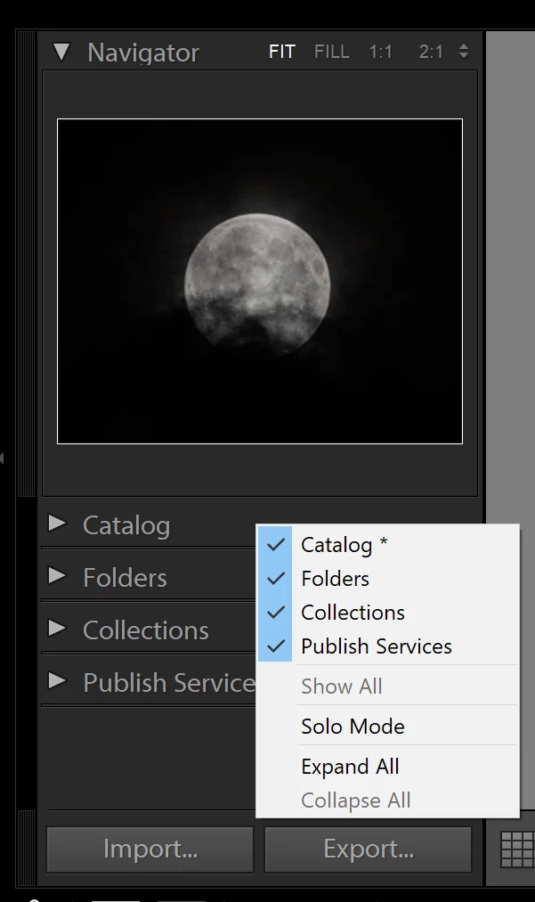

Apr 17, 2020 7:09 PM UTC
Hi there,
Would you mind sharing a screenshot the left panel of the Library module? Is the external drive that contains your images connected to the computer? Also, please share the version of Lightroom Classic you are using along with your computers operating system.
If it is the Folders sections that you are not able to see in the Librry module, right click on any of the headers like Catalog, Collections, etc. and ensure that all the options are checked link in the attached screenshot.

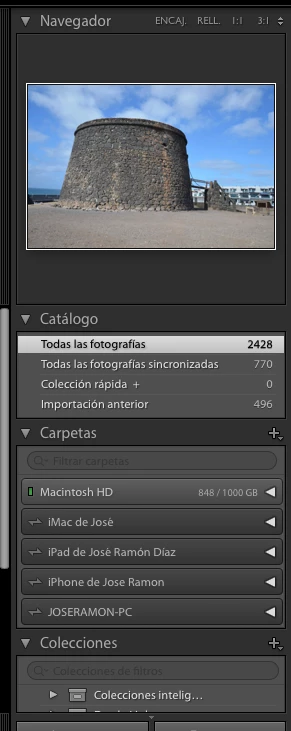

Apr 18, 2020 10:36 AM UTC
Hi. Thank you for your kind response. I am attaching the part of the Library screen of my iMac, which is my operating system (OS). The Lr version is the Classic and yesterday I downloaded the latest update. And yes, the external disk is connected to the originals. I trust this information will be useful to you. Best regards.
