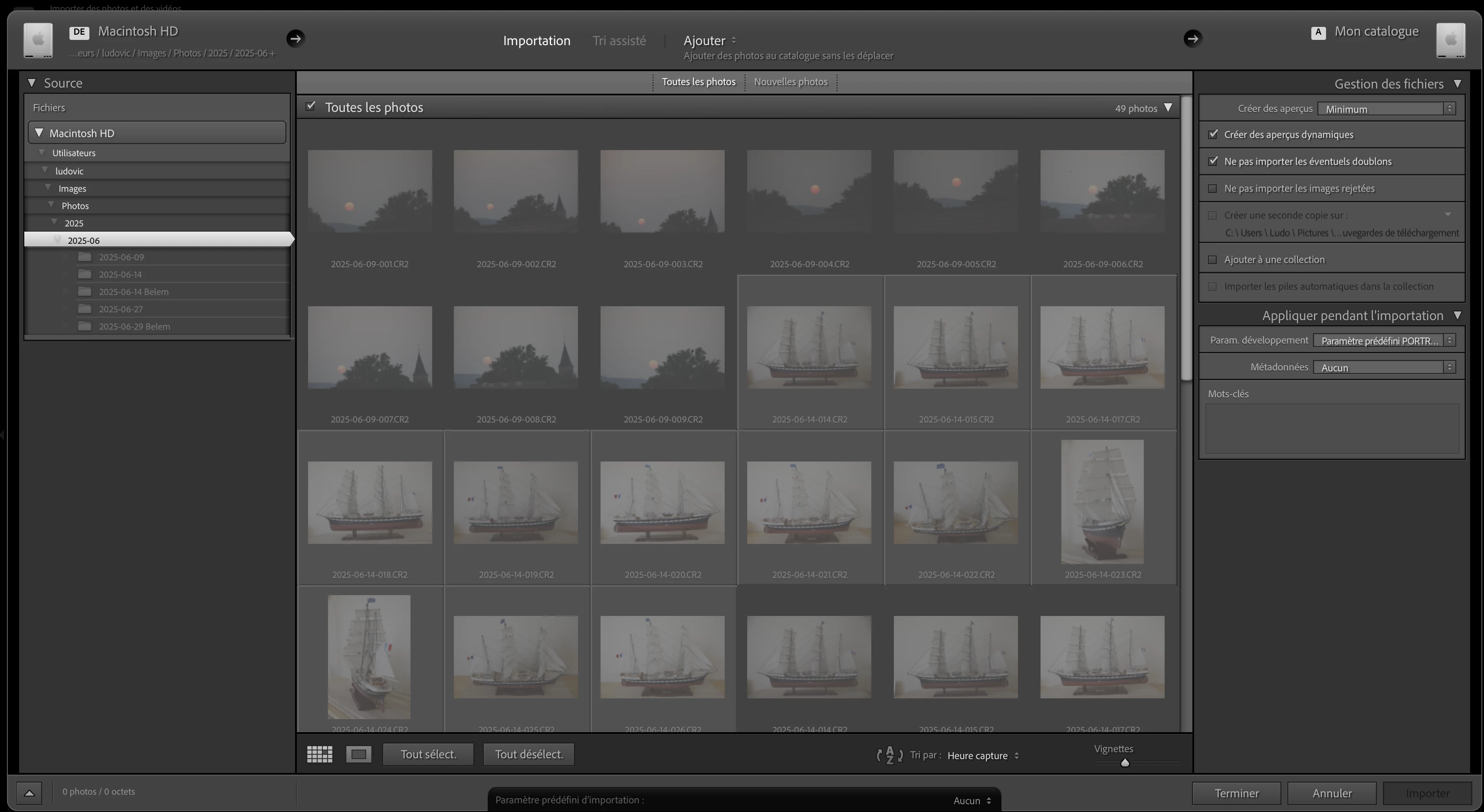

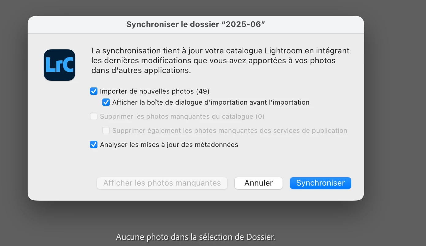

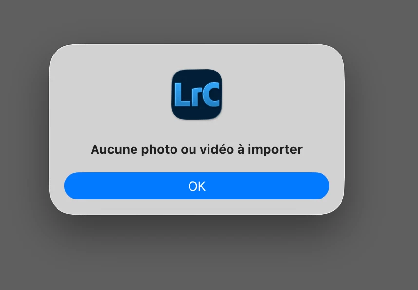

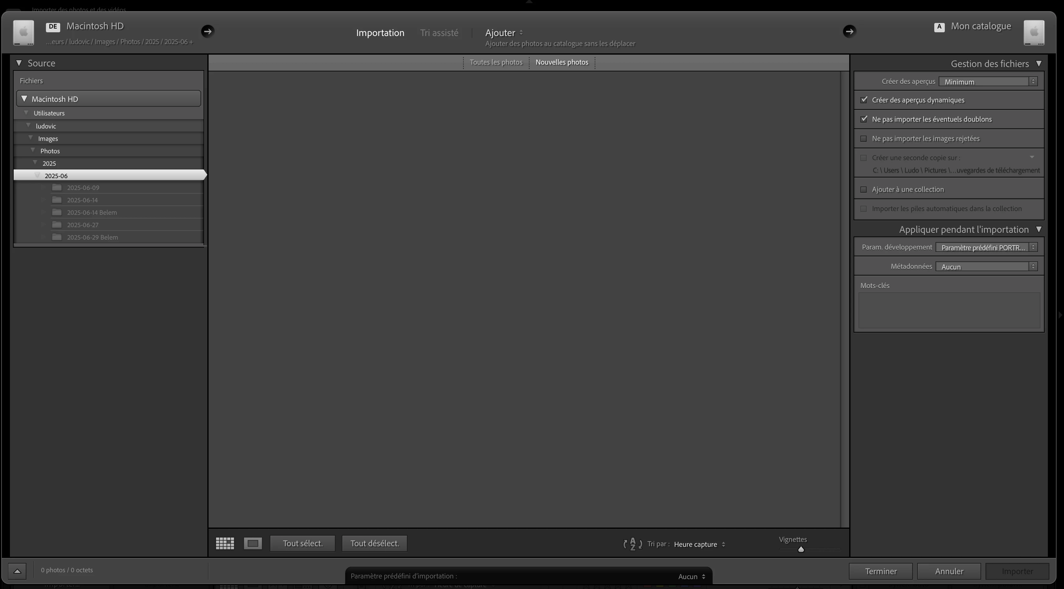

Bonjour, depuis la récente mise à jour LrC 15.0 sur MacOS 26.0.1, plusieurs dossiers apparaissent vides. Pourant les photos sont bien dans les dossiers. Si je tente de synchroniser un dossier vide avec la boite de dialogue, les photos sopnt visibles mais grisées car non repérées comme nouvelles photos.
Sans la boite de dialogue, aucune photo n'est importée.

dj_paige
Nov 9, 2025 2:56 PM UTC
These photos have previously been imported into LrC, that's why they are grey, but they are not in the folder in LrC you think they should be in. How does this happen? You have accidentally imported the photos previously using COPY instead of Add. So LrC knows about the copies it made, in some folder you didn't want to use, but does not know about your originals in the folder that you see in the Mac Finder.
You need to find these photos in Lightroom Classic. Please follow all four of these steps in the Lightroom Classic Library Module, in order.
1. Click on All Photographs (its on the left under Catalog)
2. Turn off all filters (Ctrl-L once or twice)
3. Expand All Stacks (Photo->Stacking->Expand All Stacks)
4. In the Filter Bar, search for a photo by File name
Let us know if you find the photos this way.
ludovicb35012304
Nov 9, 2025 4:04 PM UTC
Hello, and thank you for your reply,
I did not make any particular manipulation that could have caused this problem. It's been since the October update.
I followed the 4 steps, but in step 4, I can't find my missing photos.
Thanks
dj_paige
Nov 9, 2025 4:27 PM UTC
You did it accidentally. You probably are not aware that you did it.
In the LrC grid, try steps 1-3 and then performing step 4 a a different way: sort by filename View->Sort->File Name. Now the file names are in alphabetical order. Scroll up or down until you come to the place alphabetically where this photo should be. Can you find ithat way?
