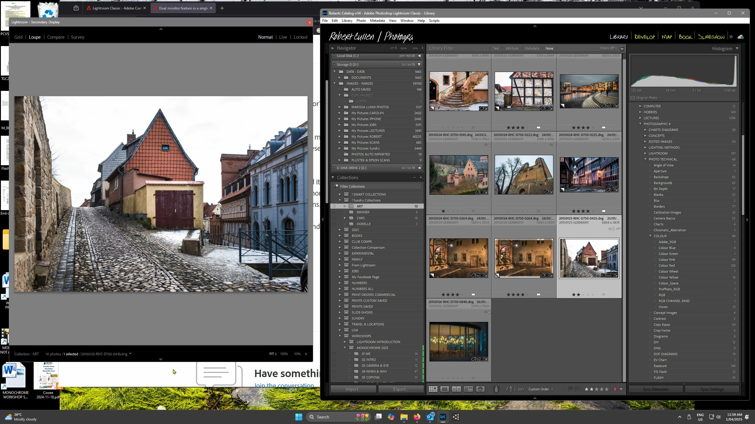

JohanElzenga
JohanElzengaCommunity ExpertCorrect answer
Apr 1, 2025 8:56 AM UTC
You can easily use one screen, as @Rob_Cullen shows. I have used such a setup in the past. Just realize one thing: you cannot use 'full screen' or 'full screen with menu bar' for the main window in that case. You'll have to use 'normal' because you'll need to be able to resize the main window.
-- Johan W. Elzenga
Rob_Cullen
Apr 1, 2025 2:02 AM UTC
FYI Windows-11 will easily display the secondary window with the main window on the one screen. It should work on an ultrawide monitor.
