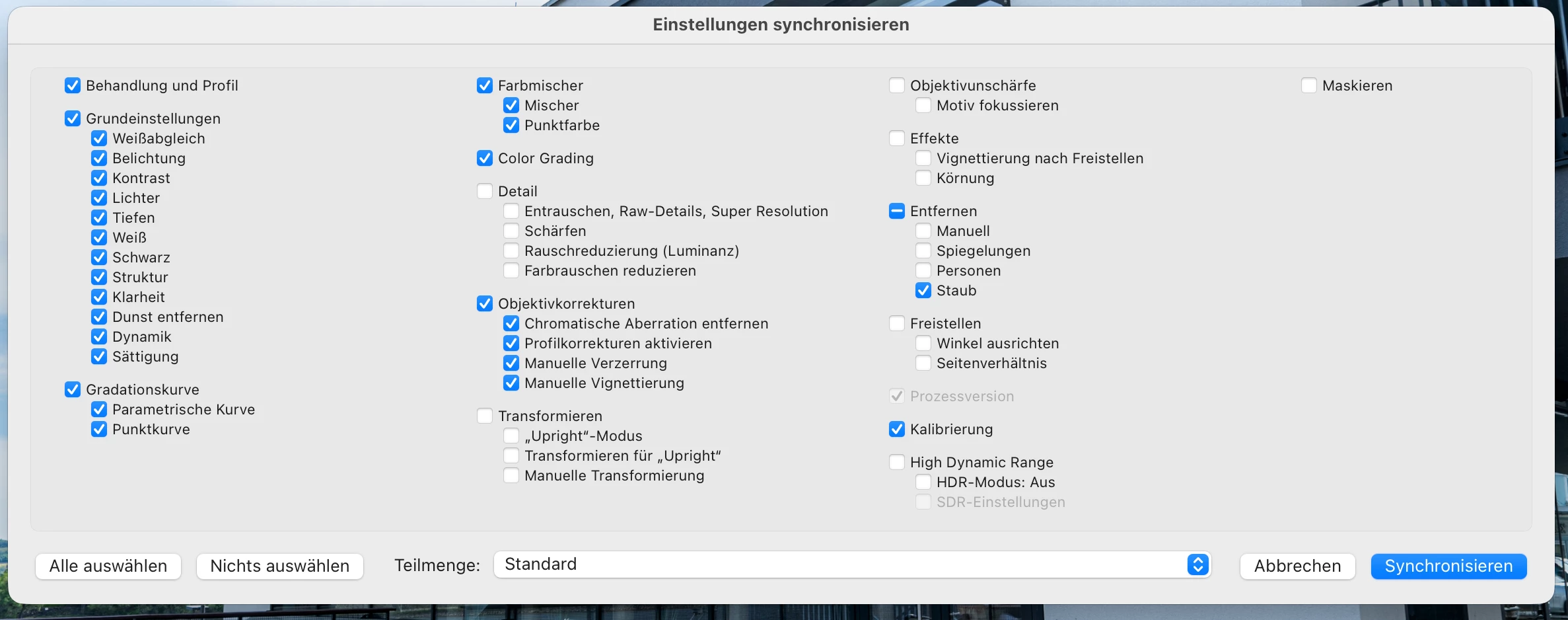

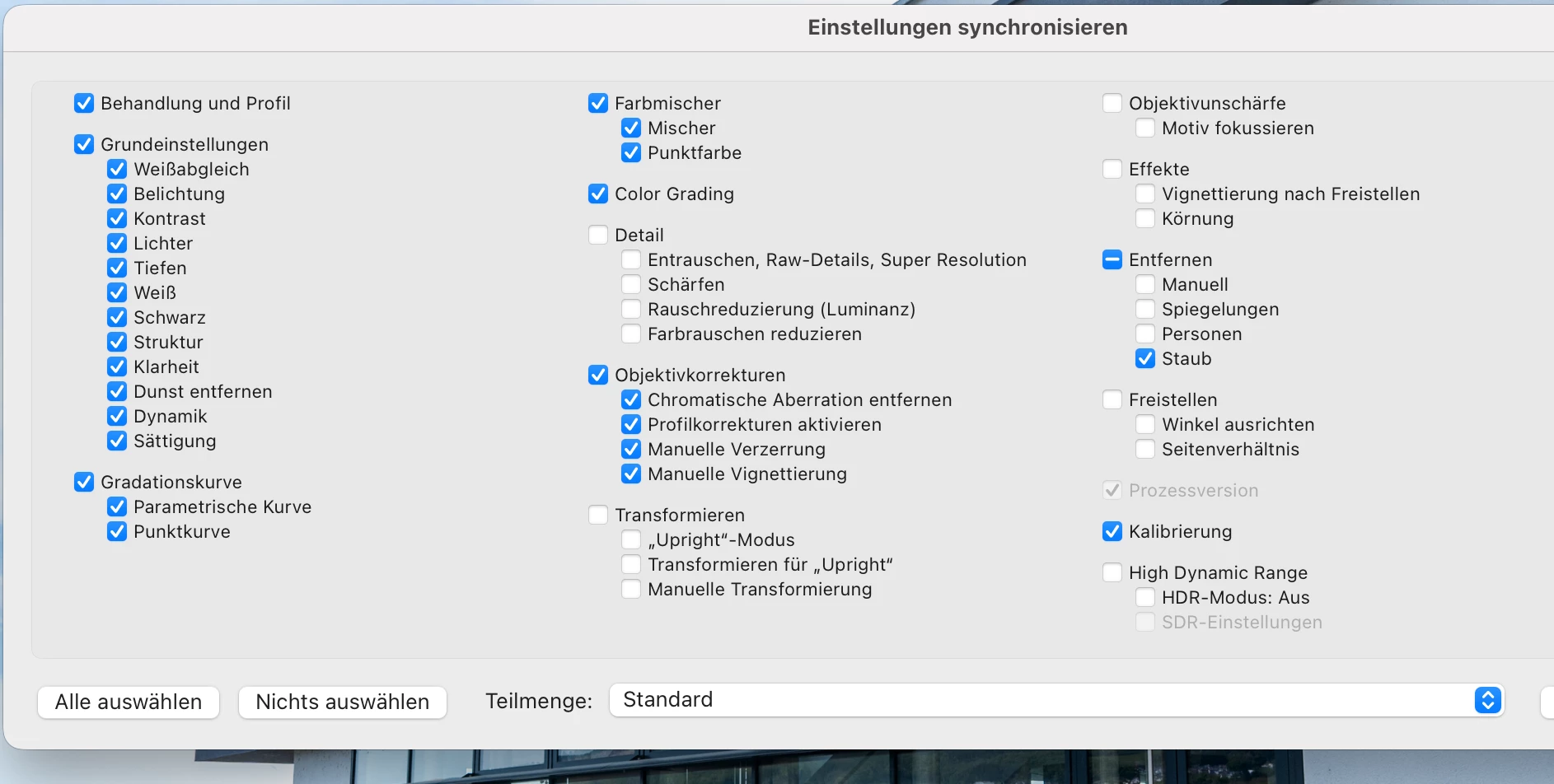

    May 4, 2026 8:34 PM UTC
    Hallo,
    yes these are my steps:
    1.) there is a stack of 2 raws. (for example).
    2.) "Dust"-checkbox under "Remove" is selected on the first raw-pic.
    3.) now the synchonisation-buttom is pressed.
    4.) the copy-select-window opens and "Dust"-checkbox under "Remove" is selected
    5.) after the sync-function is finished, the remove-dust is copied to all raws in the stack
    6.) but when opening the raws from the stack, the remove-dust-function worked not properly. in some raw-files not all dust-points are removed is good as in the first raw-file.

    I hope, this helps for locating these issue.
    BR, Wilfried
