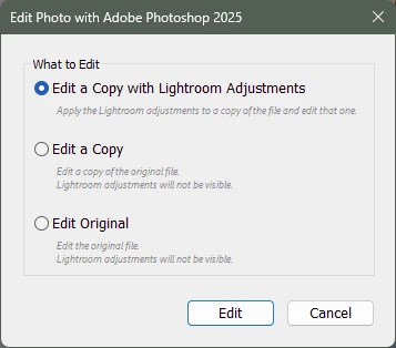

Problem Description: The core workflow of Edit In Photoshop from Lightroom Classic is failing. After a file is edited and saved in Photoshop, it is not automatically detected or imported back into the Lightroom catalog, leading to a File cannot be found error for the original file and requiring a manual re-import. This issue has persisted for over 9 months, across multiple software and operating system reinstalls.
Steps to Reproduce:
In Lightroom Classic, I select a RAW file and right-click, choosing Edit In > Adobe Photoshop.
I select Edit a Copy with Lightroom Adjustments and the file opens in Photoshop.
I perform a simple edit and press Ctrl + S to save.

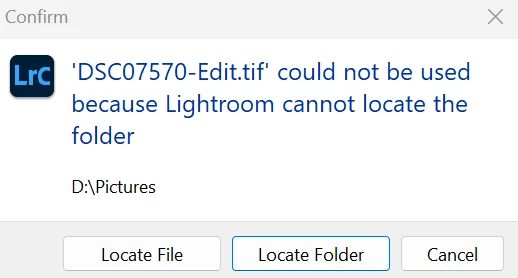

The newly created -Edit.tif file is not automatically detected. However it is located within the exact same folder. I do not change file locations.
It does not appear in the catalog, nor is it stacked with the original file, despite Stack with Original being enabled in my preferences.
Lightroom Classic displays an error for the original file, stating The file could not be found.

I have managed to fix it!
Special thanks @drtonyb , you got me on track that there was an issue locating whole Picture folder. Lightroom interpreted folder path is : D:\Pictures\2025\2025-08-16 (I provided bad path due to copying it from path that I saw in Lightroom)
However, real path was D:\Darbalaukis\Pictures2025\2025-08-16
Lightroom kept skipping "Darbalaukis location" even if I specifically show that folder location by navigating via Missing file function or locating folder via Folders tab in Library. So, I placed Picture folder to D:\ not D:\Darbalaukis. Issue solved.
Thank you all for your patience and help!

Is the path shown in your pdf "Desktop > Pictures > 2025 > 2025-08-16" on the C: drive?
LegasiusAuthor
Sep 4, 2025 11:46 AM UTC
No due to small C: drive I have everything on 😧 drive. Path is D:/dekstop/pictures/2025/2025-08-16
I have a hunch that LrC tries to check C:/Pictures drive by default?
I thinking of:
  1. Maybe I get some conflict due to Adobe programs being installed on C: drive? I will try reinstalling them to 😧 drive and check if the problem remains.
  2. Trying to change my catalog folder that it would not be within D:/Pictures?
Your help leads me to believe it might be the problem.

When you select the returned PS edited file, which LrC finds is missing, can you try and find the file location where LrC 'thinks' it is?
By @drtonyb
@drtonyb You might be onto something here , when I start searching for missing file, I get a table that lightroom cannot find D:\Pictures folder. When I try to locate folder itself I get an error I will attach 2 photos of what I get here.
I am thinking maybe I can try to create a catalog that is not within the D:\Pictures folder might help?

Since both ARW and DNG are RAW files, Edit In.. Adobe Photoshop 2025 should open directly into Ps. You should not see this:
Have you tried resetting your Preferences? If not, then locate your Preferences file and rename it to preserve it if the reset does not work.
LegasiusAuthor
Sep 4, 2025 9:25 AM UTC
@drtonyb Sorry causing unnecessary confusion I usually edit DNG files, sometimes plain ARW files. But while testing how files are going back from Photoshop to Lightroom. I have picked TIF exported file from Photoshop to lightroom which I found via missing file function. Hence, I got a table to edit with lightroom adjustments which I mentioned "I select a RAW file and right-click, choosing Edit In > Adobe Photoshop. I select Edit a Copy with Lightroom Adjustments".
However, my issue is that after doing "edit in Photoshop" no matter what kind of file format DNG,ARW,CR.2, TIF etc. My file returns as a missing file from Photoshop to LrC.

@Rob_Cullen is correct. It defintely appears that you are not editing a RAW file. You don't show what type of file you are editing, making it difficult for anyone to help you. XMP has nothing to do with opening a file from LrC into Ps.
What type of file are you editing in LrC?
LegasiusAuthor
Sep 4, 2025 8:16 AM UTC
@drtonyb @Rob_Cullen
I usually work with ARW file converted to DNG. Which I believe is the right way, or I am I missing something here?
Even if I don't convert ARW to DNG and add file as ARW it has exact same problem. Where on my other workstation it works in both cases.

A comment- An early step in your workflow is not typical behaviour of Lr-Classic-
With the [Edit-In] command: Any proprietary RAW file (CR3, NEF, RawDNG, etc) should open directly in a Photoshop document window. Only rendered RGB files (JPG, TIF, PSD, PNG, ) should show the options that include- "Edit a Copy with Lightroom Adjustments".
So yes, something is amiss, but I do not know what.
