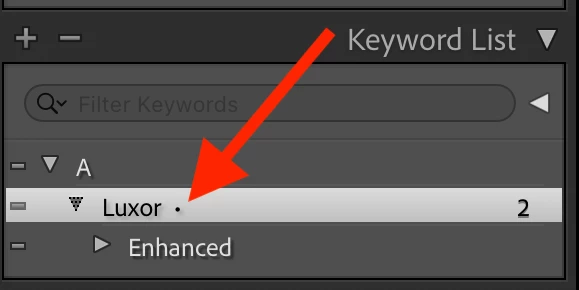

You didn't say what you did to fix this, but for future readers, it sounds like you had set the option Put New Keywords Inside This Keyword for the Luxor keyword. Thus, the Enhance command added its keywords under Luxor.
Interestingly enough, a "." and a "*" also appeared next to the Luxor name in the keyword hierarchy.
In the Keyword List panel, a "•" to the right of a keyword indicates new keywords will placed inside that keyword:

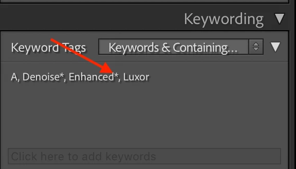

In the Keywording panel, when you have multiple photos selected, a "*" is appended to keywords that are assigned to some but not all of the selected photos. In your example, you had probably filtered by the keyword Luxor, and only some of those photos had the Luxor > Enhanced keyword assigned:
